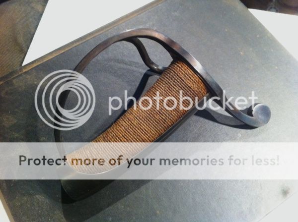

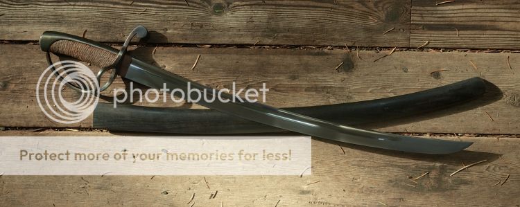

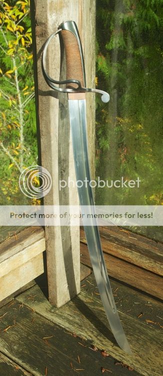

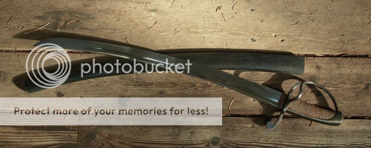

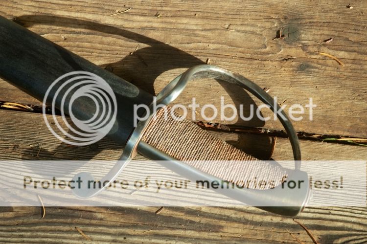

It's been a while since I posted anything. It's been a summer of experiments in laminating steel, working on some kitchen blades and this little proiect. I've been working on it in bits over the last couple months, in between other things.
I've always loved the design of the Napoleonic infantry sabre, the briquet. I figured it would be a fun little sword so I finally, after a couple years of thinking about it got out the bar of L6 I bought ages ago for this.

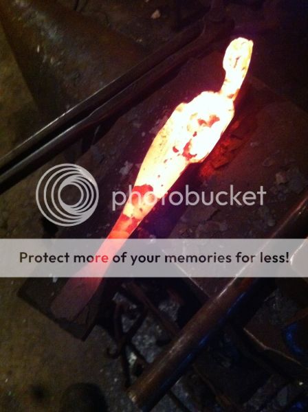

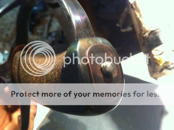

There was a lot new to me on this. The fullers were forged in. First D-guard too. Forging the guard was a mind-bender and took two tries.. so was that back strap piece. These started as an old piece of anchor chain so there was some major forging to coax them into these shapes.
The scabbard isn't done and I'm not sure how far to take the rest of it. There's still some forge marks on the guard and I only took the blade to 400x.
I wondered whether to post this as I'm not sure it's finished but it's as finished as it will be for a while. I am going to take it to Lorien's to test the steel and have some fun first.

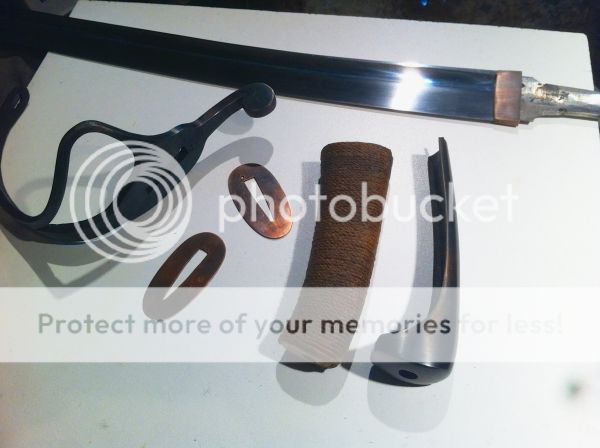

If you're wondering about the habaki.. well I forged in the fullers and then had to shorten the blade from the tang end and so the fullers would have run into the guard. I thought the habaki was a nice way to make the transition and though not at all traditional, I think it looks quite good.
The blade is 24".
At this point in the forging of the guard, I hot cut a slit with a chisel and forged the side tine out to shape.

Re the habaki. On "real" swords the fullers can run under the guard. Fit and finish standards are different from knives.
Thanks for the kind comments. As I said, I was hesitant to post this as uncompleted but I think it's close to it's potential at the moment and served as a great learning experience for a more refined sabre in the future. It's only by trying these things way outside my comfort level that I can even begin to grasp the work of a Kevin Cashen or a Vince Evans. Well, actually, by trying these things it usually gives me more questions.. :)
Re the habaki. On "real" swords the fullers can run under the guard..
I did see that but more often not. It just seemed like a stronger construction choice in this case.
Just to be clear -- I'm not criticizing. :) it's hard for a knife maker to leave a gap anywhere.
Exemplary job on a tough challenge. Turned out great. Love the guard and backstrap, but that long fuller had to be a real bugger. What's the handle wrap?
