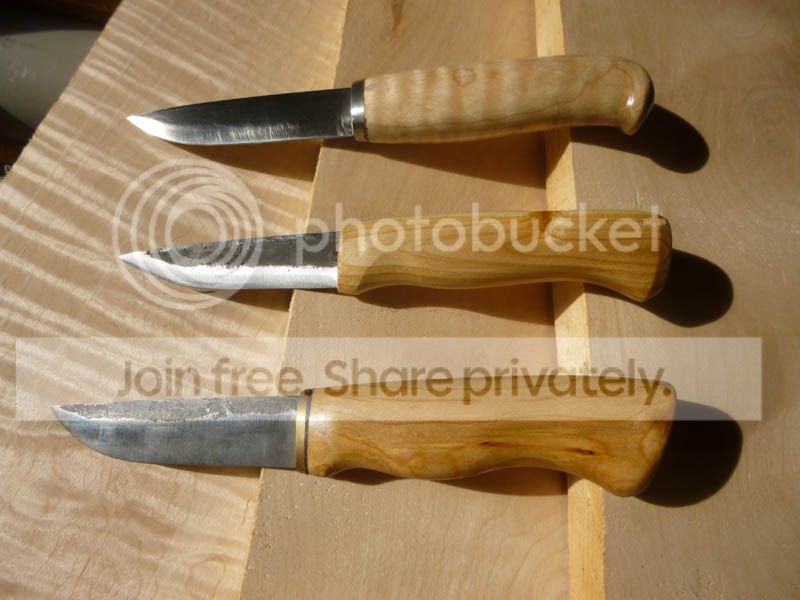

I've tinkered with knifemaking over the years, but I've been trying to learn more about it lately. These are a few of my recent knives.
The top one was a file and curly maple. The bottom two are all found materials*: an old shovel and a tooth from a spring harrow found returning to the Earth from whence they came and birch branches found fallen in the same woods.

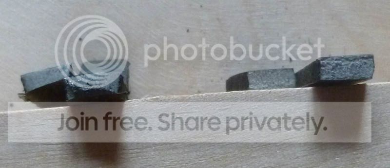

With the bottom one, the spring harrow tooth, I decided to do some destructive testing on some samples. I heated them to non-magnetic with a propane torch, quenched in canola oil and then tempered at 400, 450, 500, and 550 for an hour on various samples. This is the same treatment I give the blades (tempering at 400, except for that bottom knife which was tempered with the sample pictured below), except that with the blades I heat to non-magnetic in a small forge and let them cool to black twice before the final heat and quench, which I probably should have done with the samples as well. The result was the same in all cases, the pieces snapped with very little bending.
Below is a picture of a piece cut off the harrow tooth and broken (left), which bent quite a bit before it snapped, and my last sample (tempered at 550). I can see that the grain is somewhat coarser in the sample.
In "real life" use (woodcarving, etc), I haven't had trouble with any of these knives, so maybe this is more of a theoretical problem than an actual one, but I'd rather know they're tougher than those samples. I would not be inclined to think I overheated the steel as the equipment I'm using is kind of hard pressed to get it to non-magnetic much less hotter, but maybe. Any ideas?

What would overheated look like? This steel only got to just non-magnetic, so maybe a bright orange.
Is there anything else that would cause grain growth like that?
Non-magnetic is quite a bit cooler than bright orange!

That used to happen to me when I first started. I only had a forge and I would heat it up to a touch over non magnetic and I would quench in canola oil. I would temper in a old toaster oven . After this process I would finish out the grinding thinking everything was OK . One day I wanted to if it had any flexibility and put it in the vise .. It snapped and had some really coarse grain like yours .

1)CONTENT - A knife made from an unknown steel may be problematic in HT. Your steel choice probably isn't the cause of the trouble, but this is always a concern with second use steel. Beyond the carbon and alloy content, which one can guess at somewhat reasonably based on its past life, there is the internal condition from the former use and HT...which you can't know. The grain size is unknown, and there may be many microscopic disruptions in the grains from repeated use and flexing. Consider a leaf spring or harrow tine. The steel may be assumed to be 5160 for a leaf spring and 1080-1095 for a harrow tine. That will be good enough for a guestimate HT regime. A grain reduction cycle will reduce any possible large grain size. The problem is that the flexing over many years of use may have done things to the arrangement of the grains that will not be repairable easily, if at all. This is why using a new and known alloy content steel is recommended.
2) CONDITION - If a blade is forged, it goes through many long and high temperature cycles, followed by cooling as it is forged. The normal forging range for a high carbon steel is between 2100°F and 1500°F. At that temperature and repeated cycles, the grain will grow...sometimes to huge size. This is of no concern until it is time to harden the finished blade. If you just austenitize ( heat up a little past non-magnetic) and quench in oil, the resultant grain will be roughly what it was before the quench - usually large. Large grains disrupt (breaks) much more easily than fine grain. A grain refinement cycle is how to reduce the grain size ( and subsequently the brittleness). Start with a soak at a temperature that is well above the HT target. For simple high carbon steels, the HT target is between 1450F and 1500F, so start about 1600F. Heat evenly and hold at that temperature for about 5 minutes ( if using a forge, heat as close as your eye can guestimate and hold for a minute or so). Air cool to black and cool off in water. This will get everything in solution and set the grain size at a starting point. Re-heat to 1500F and when the hold is done, quench in the appropriate oil. Reheat to 1400F and quench in the appropriate oil. Now the grain size has been reduced to a much smaller size, and the steel is in a condition that will allow a good final hardening. Heat to the target temp, usually about 1475F, and hold for up to five minutes, then quench. Temper twice for one hour each at around 400F. Cool between the tempers and after the second by dunking in water or holding under a running faucet. Judging the HT temperature by eye is very inaccurate...often by several hundred degrees too high. A magnet helps get you in the ball park, but you are still guessing in a critical place where 25° can make a lot of difference.
3) TEMPERING - Tempering converts the very brittle fresh martensite into a tougher tempered martensite. This is very important, or the blade will fail in use. Most people temper far too low. A properly hardened steel like 1095 will be at Rc663-64 with a temper of 400F, and at Rc60-61 with a temper of 500F. The words to notice are "properly hardened". Most people don't get the full potential from their steel. Unless using a non-standard knife steel, all tempering should be at or above 400F. Tempering will make the grains a bit less likely to come apart ( break/chip), but it won't cure large grain size. Blade steel is in thin sections, and the HT and temper are fairly basic, so two one hour tempers are all most blades need. A few very high alloy steels need other treatments ( sub-zero/cryo) and longer or additional tempers.
