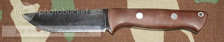

hey everyone, i just joined yesterday (after reading multiple discussions off google for a long time!) anyways, i am not new to the knife world but am to the brk&t/convex grind world. i just recently got a bark river b1 in black canvas in a2 and i love it! the handle fits great, blade profile is awesome and just looks awesome! i just wanted to know from more people who own a b1 or similar bark rivers what they think. main concerns on rust problems(any a2 barkie really)and edge holding. the thumb ramp looks cool and is sometimes useful but am cosidering grinding it off. any body know of a good way to do this or if this will effect the balance or mess with the temper?also, im not crazy about the kydex sheath,although a good design i prefer leather and have considered all the leather on ksf website but cant make up my mind. i am always outdoors hunting alot,fishing, and camping. i plan on skinning, carving,cutting anything really.

You will find that A2 is a great steel. I am very impressed with its performance. It will rust, but heres a pic of my Gunny after a week of use on the coast. It was used wet with salt water, not cleaned, and used alot. As you can see, there was some spotting, but nothing that didnt clean right off.
