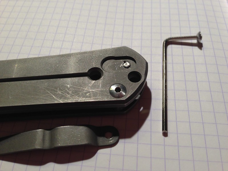

Well, I took my pocket clip off today to attempt to bend it back a bit after I caught it on something and bent it out (wouldn't grip my pocket)
I got it bent back ver close to how I wanted it and then put the screw back in. when screwing it back in, it was stiff, but didn't give me any trouble. It got to the end and I snug it like I do all screws and it just snapped at the head. I don't push hard or anything whenever I snug a screw, I work in a machine shop in the summer and got a good feel for it after stripping aluminum out too many times. I put the same amount of force on it that I do on an aluminum part.
So my question is, How can I get the screw out?
or is my best best to contact CRK and see what they can do for me?
thanks for the help

Looks like you have room to clamp some vice grips on there and twist. But having owned a Sebenza, I know those clip screws have some tension when screwing them in, so idk if you would do more damage to the Ti side or not.
Honestly, call CRK, and see if they can deal with it for you.. Maybe a good excuse to get the Spa treatment done to her.. :)

I suspected I might have to give them a call. I tried getting a pair of pliers on the screw, but there isn't enough there for me to be able to grab. I guess I will be contacting CRK. this really put a damper on my day...I decided to tweak the pocket clip a bit before I started my day and this happened....oh well, at last I can still use the knife. I'll just carry my zt (heavy as it is) until I get this dealt with or get a sheath for it...

You could drill out the center but if you don't feel comfortable doing it, I would just send it in. Better to be without your knife for a week or two than forever.

Unfortunate it was firm going in. If it were easy to move while being tightened, all tension would be off when it broke. Try your fingernails anyway, you might be surprised as long as the screw didn't bottom out. Carefully Dremmeling a slot and using a screwdriver is another option that often works. Having said all that CRK will, no doubt, do right by you without the risk inherent in a DIY fix. Good luck.
I would think it best never to use the long end of the Allen wrench in tightening. Too much leverage. Without speaking of an inch/lb wrench; the torque on those ain't much.

You can just drill it out as mentioned and there are even specific bits for removing "threaded obsticals", but if you're not sure about doing that then CRK will sort you out.

As stated in the posted link I have had really good luck with a soldering tip directly on the screw head or broken shaft, it breaks the loctite seal pretty easily in my experience, even red.
I got an email from CRK, they said to send it in if I couldn't get the screw out, and if I could get the screw out then let them know and they would send me a new screw. since I was planning on getting some engraving done, I am pretty sure that it is getting sent it
