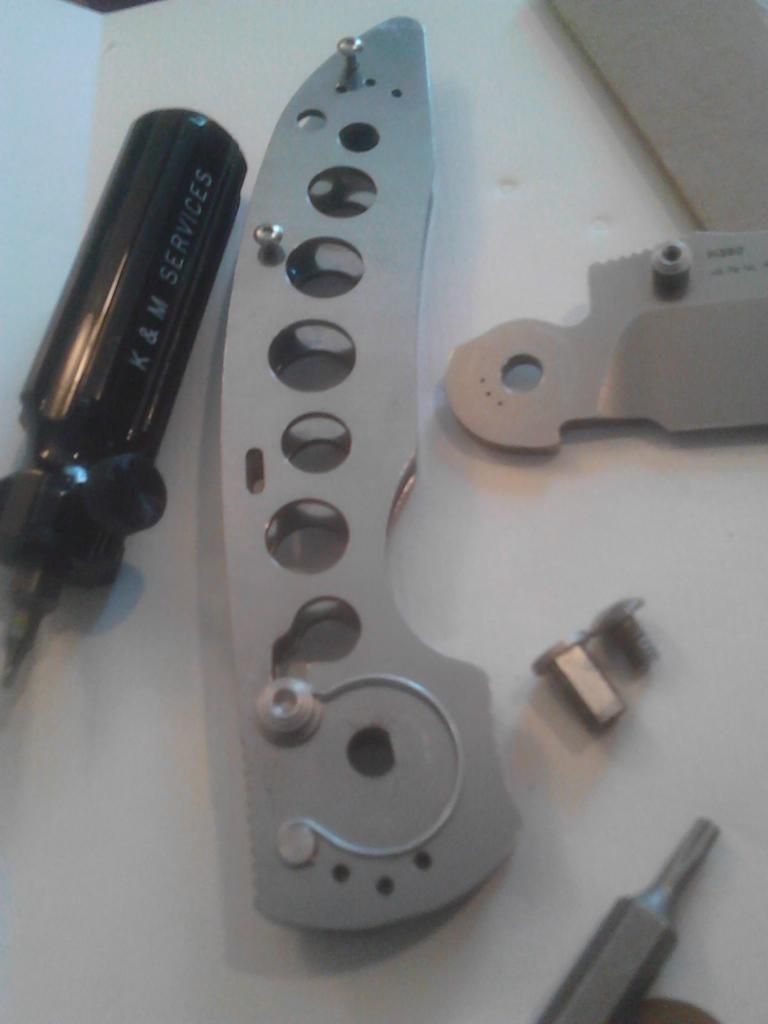

Just to clarify I don`t think the springs are a weakpoint,the spring that broke on might have been due to the fact that I rehandled it,but that is not the point.

They are just .022" spring wire in the shape of an Ω.

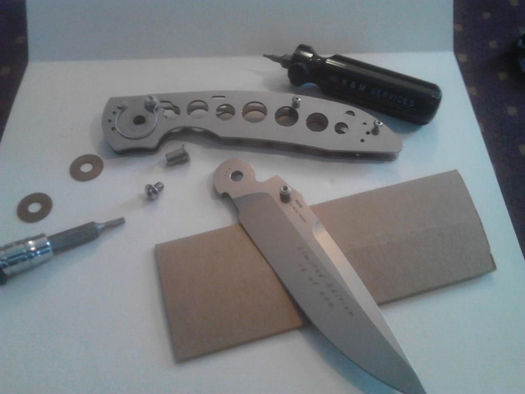

If you send a knife into Life Sharp they can inspect the springs and replace them. Just did it twice with my two Mini Griptilians. New springs, new pivot, washers, screws and clip.
If you don't look closely to find the wear on the handle these now look almost new.
I wish all of the Omega springs were set up like this. Straight around a post, into the liner as opposed to.. bent through a hole in liner.

Anyway, I got new springs, a replacement clip and some new screws after contacting the people in charge of warranty work here (Sweden) and it was rather easy to just switch them out. Warranty work like this is almost easier to sent parts for unless the owner is completely incompetent, if I were to send it away it'd take a month to get it back.
I'm guilty of flicking my benchmades when I'm bored and have gone through enough springs myself. It's silly that they don't send. We should have the option to void our warranty to get some. I started making my own. I ordered some .022 music wire from amazon and use a round nose pliers to make the bends. You can find some nifty tools at craft stores to make the bends you need. I'm going to try .024 to make it a little stiffer but .022 is really close to factory.

I recently broke a spring on my mini barrage. I fashioned two new springs from .025" (.64mm) music wire. I replaced both because I wanted to use a slightly heavier gauge. Works better than new. It even took out the slight vertical blade play its had.
