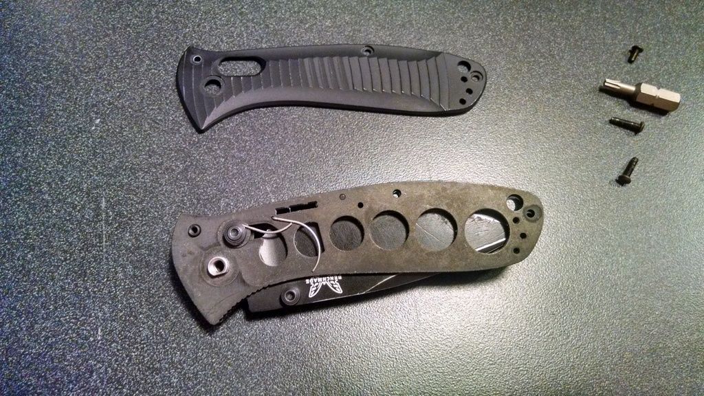

Well, popped my broken Omega spring cherry today. Carried this 525 on and off for 2 years now and the Omega spring gave out today. Took the scale off and other than a little pocket lint cant see what would have caused it.
Im assuming Benchmade still makes you send the entire knife in for a little spring? [emoji34] Fortunately I have a 527 mini presidio i can rob one from. Good thing to have multiple knives...
That stinks. Look on the inside of the scale and see if there is a spot where the spring was rubbing.

Already cannibalized my 527 and took both the Omega springs out. My 525 is back up and running and I have one spring ready now as backup when another one fails.
Holding on to the broken spring to send in with the 527 to get replacements. I don't particularly like the 527 "ultra" presidio version and only reason I kept it around was to use as back up parts for my 525 in this exact situation.
Wanted to update this thread. Today the Omega spring on the other side of my 525 has broken. I'll post pics when I get the knife apart.
Now my 527 will be stripped of both its springs, guess it's time to go through the hassle of sending the entire knife in. Extremely irritating Benchmade won't just mail you the springs when they are so prone to failing.

The spring is not rubbing on anything and I keep the knife reasonably clean. The only explanation I can come up with is that the omega spring being a very thin gauge metal wire and being put under stress during every open and close it eventually just gives out.
My knife is constantly in and out of my pocket at work to cut things open. Ive been carrying my 525 the most as of late as I really like it. I either need to stock up on Omega springs or carry it less to spread out the wear on the springs.
