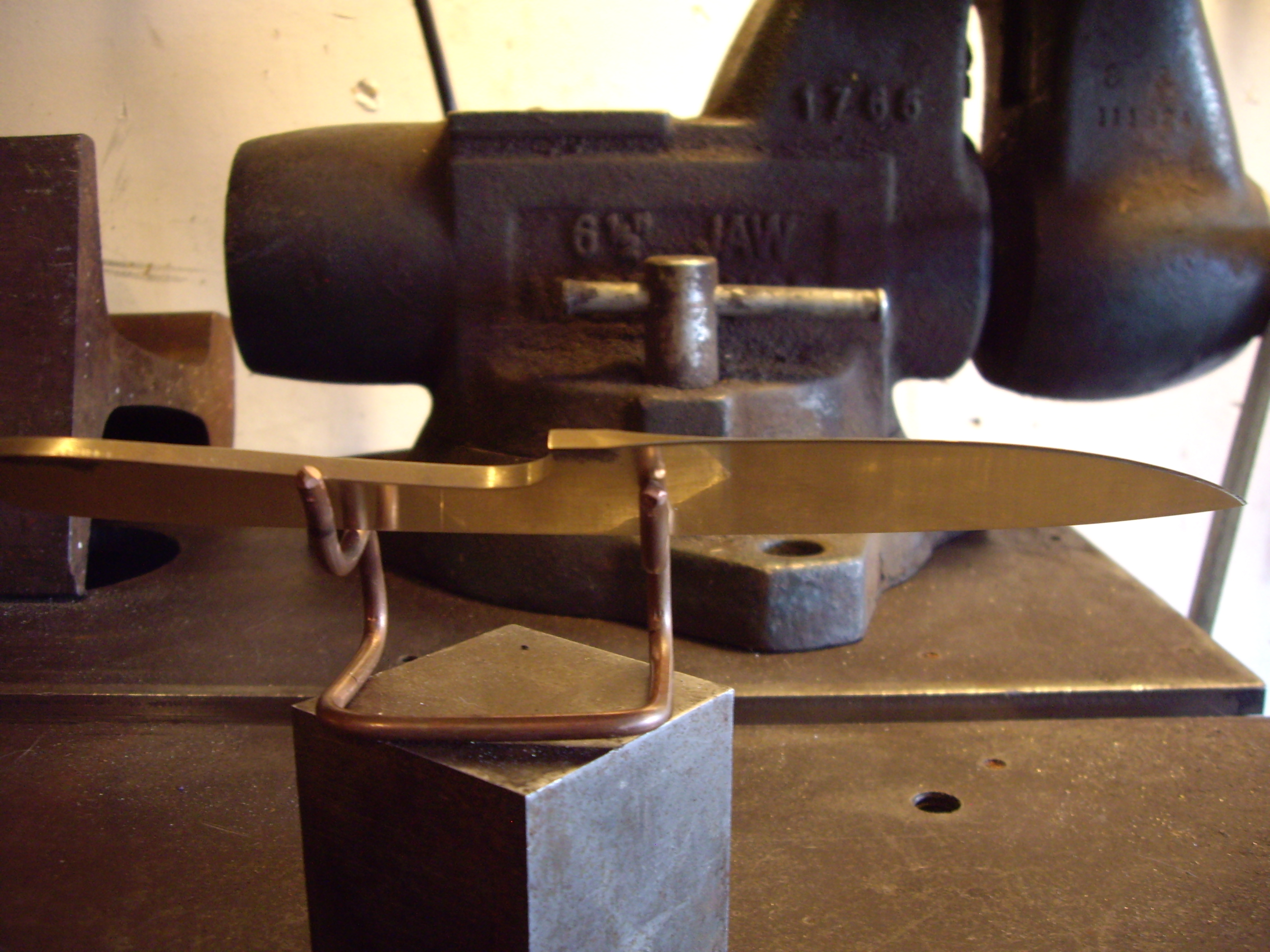

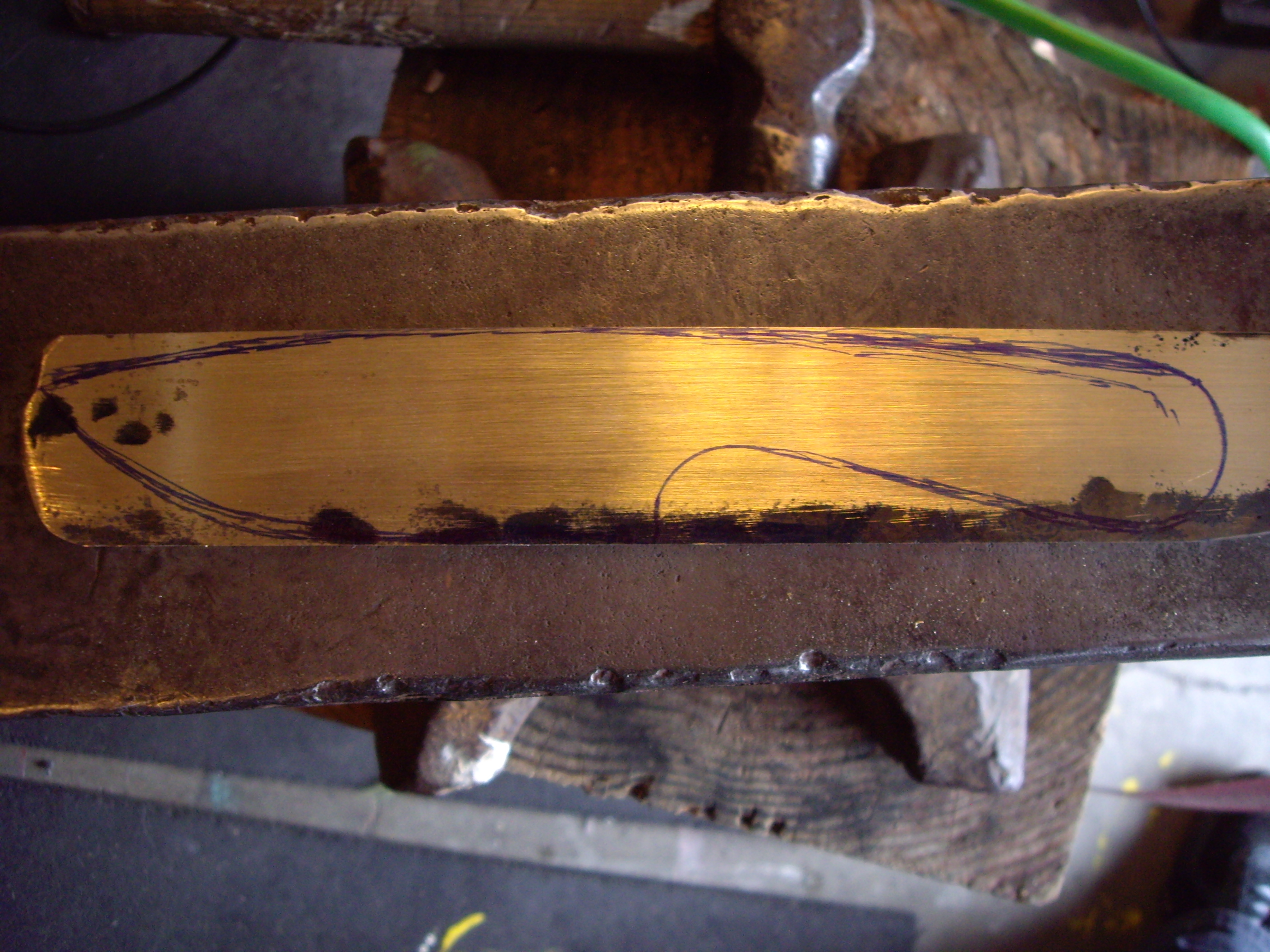

More photos!
Well, it slices up a business card cleanly.
I think that is just so freaking cool. What an awesome knife idea. Sure maybe not the most high performance knife ever, but who else is going to have a bronze knife?
We can thank The Government for this bronze knife exposé!

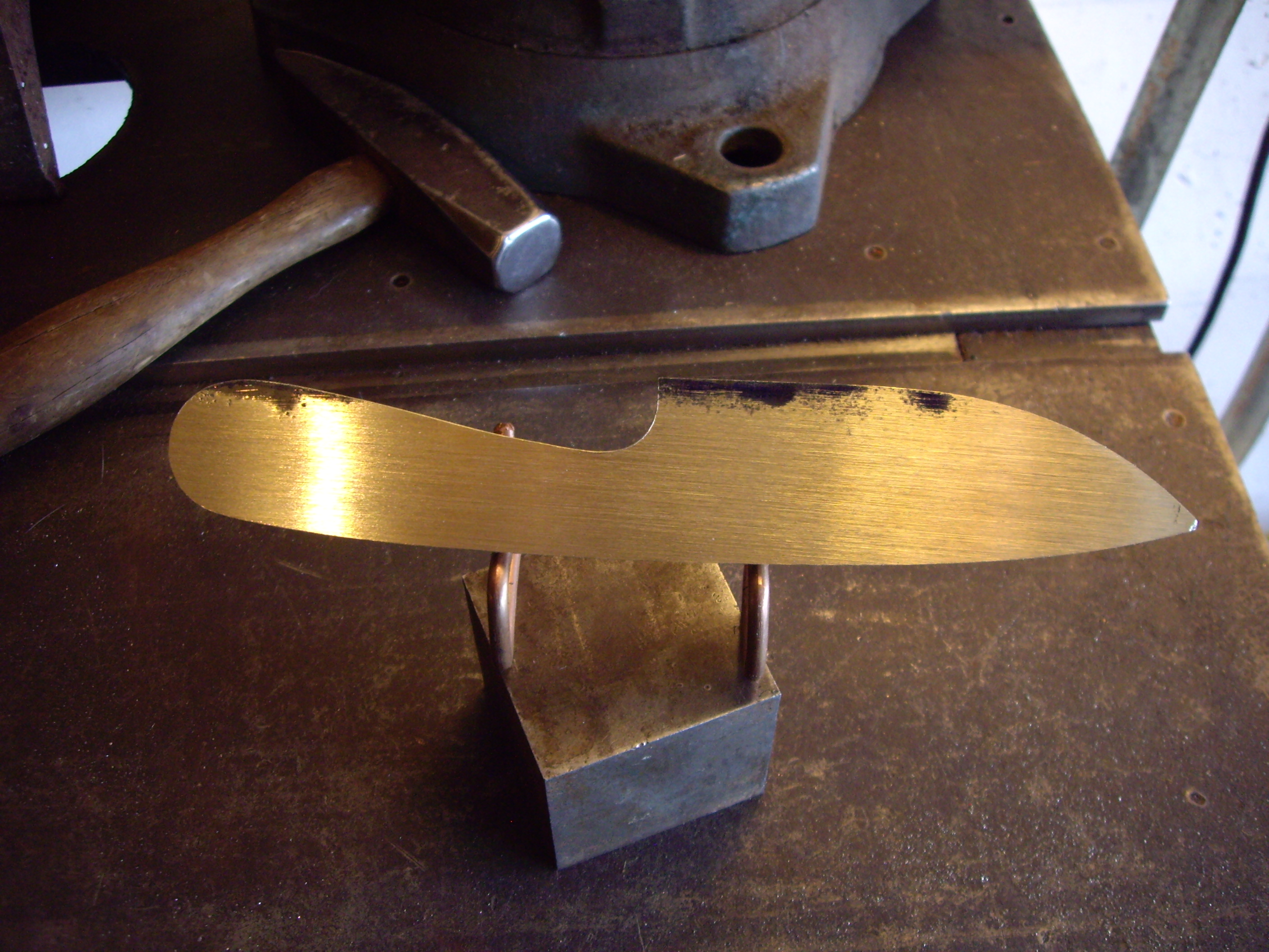

Just got more info back on the bronze stock. It was original equipment from a wooden fishing vessel made in Seattle in 1941, one of the very last before WWII put the USA in war-mode and wooden fishing vessel production was sidelined for a time. This probably has something to do with the large steel fishing vessels that appeared after the war.
The edge of the blade was work-hardened by rap-tap-tapping up and down the edge cold with a small hammer, right before the final grind. The knife is a bit flexible.

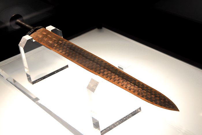

Lorien - It helps that bronze is such an easy metal to love. My favorite sword of history is one that shows how nice a bronze blade can be, worth a look if you haven't seen it: sword of Goujian, king of Yue.
This link begins a three-part 15-minute documentary about the sword, including the metallurgy aspect.
[video=youtube;c-qJ4JYNZ3g]http://www.youtube.com/watch?v=c-qJ4JYNZ3g [/video]

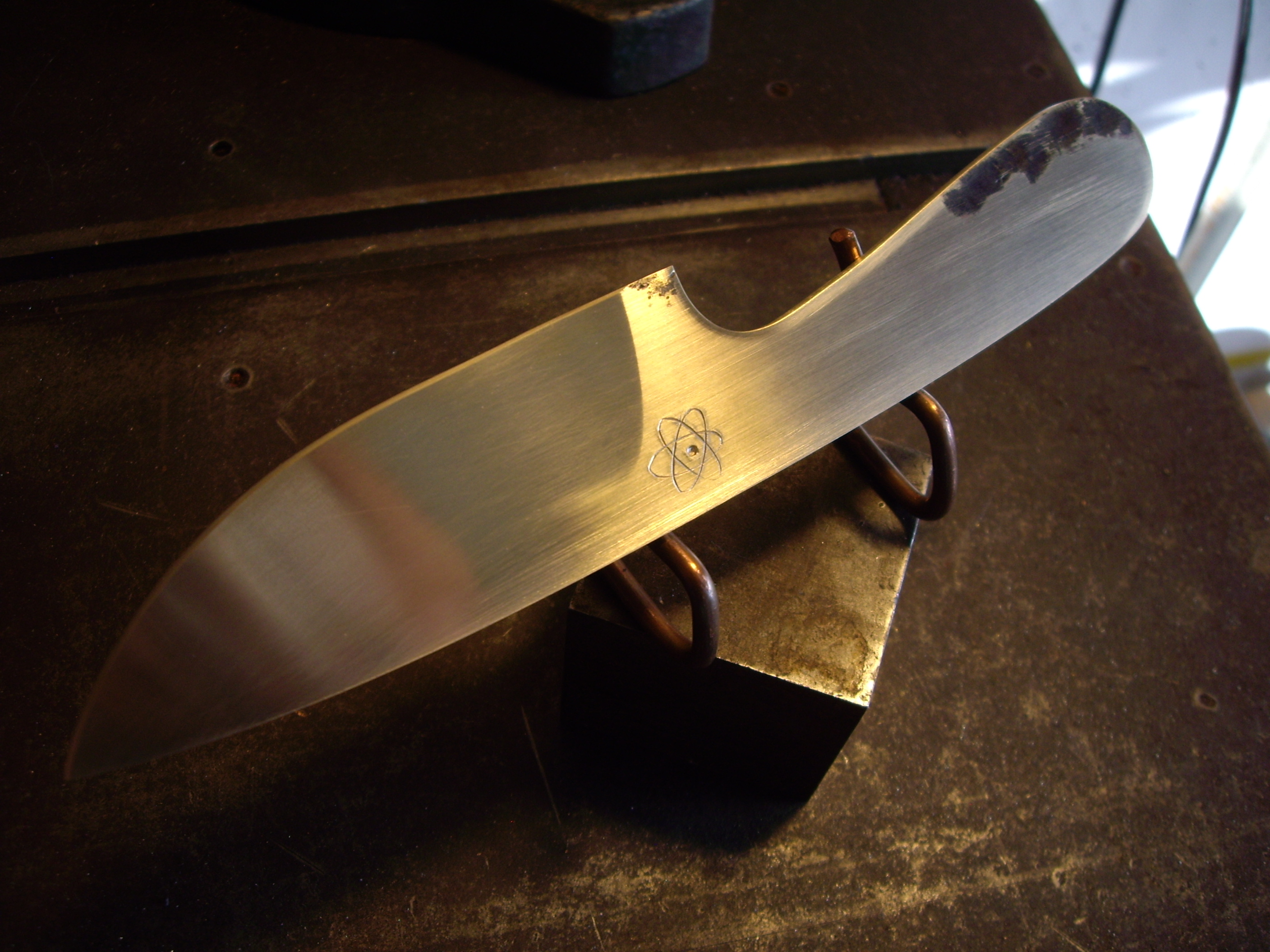

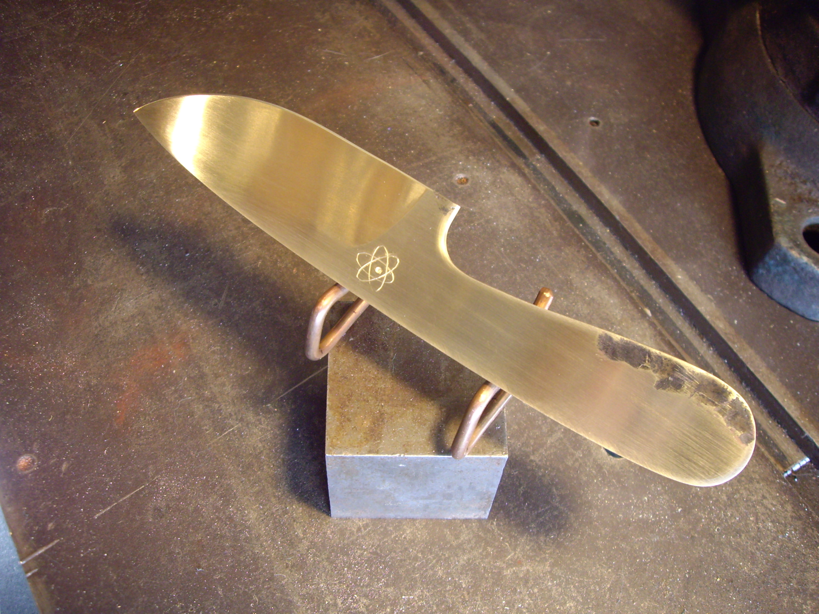

Shaped two more little "edc" type knives from the fishing vessel bronze, one convex and one more contemporary blade.
I didn't want to clutter up your sales thread, but I think those knives are just ridiculously cool. I sadly cannot afford to buy any knives right now, or I would snag one myself. I just really get a kick out of the idea of a bronze knife.
Thanks abbydaddy. Don't worry I plan to try some tungsten-copper alloy blades in the future. It isn't a true alloy: the hard tungsten micro-bits are distributed throughout the copper almost like carbides. Combined with the work-hardenability of the copper, it could make a really neat and effective little blade.
