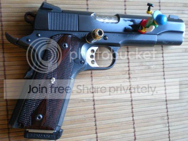

I have had good results with Oxpho-Blue. My best results were on stuff that was given a fine bead blast finish, I then applied the Oxpho and when I got the desired color I followed by applying oil that was heated a bit. I rubbed the heated oil really well and then wiped off the excess.
Here is a pic of a 1911 rebuild that I did using this method.
