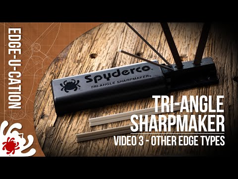

Brownie method of sharpening on the Spyderco Sharpmaker
Sals using the corner of the ceramic, when he's laying the knife on the flat, it's to remove the burr as a final step. My method doesn't use the apex of the corner of the ceramic as Sal is demonstrating and each stroke runs the tip onto the flat as it exits. Sal's not demonstrating that in this vid, but it's a great informational video nontheless.
I've had the pleasure of speaking with Sal many years ago after I field tested their Keating designed Chinook and he saw the review.
Interesting adaptation. Three comments:
1. If it works for you and produces results you like, that's awesome.
2. It looks to me like you are rounding off your tips gradually, as the tip slips off the stone at the end of every stroke. I don't know if you're experiencing needle sharp tips or just "kinda sharp tips", but that's what it looks like on video.
3. You can hit every bit of the blade, all the way up to the tip using just the flats of the sharp maker. You just have to raise the handle up as you go through the curve and to the tip, then stop with the tip on the flat.
Again, it's an interesting method and if it works for you, congrats.

I agree with the OP. If you do it the way Spyderco suggests, the final 1/8 of an inch or so doesn't touch the stone. If you angle it as suggested in the video, he is sharpening all the way to the tip of the knife edge.
That's been my experience, thus over time figuring out how to catch it before it leaves the stone. :thumbup:
