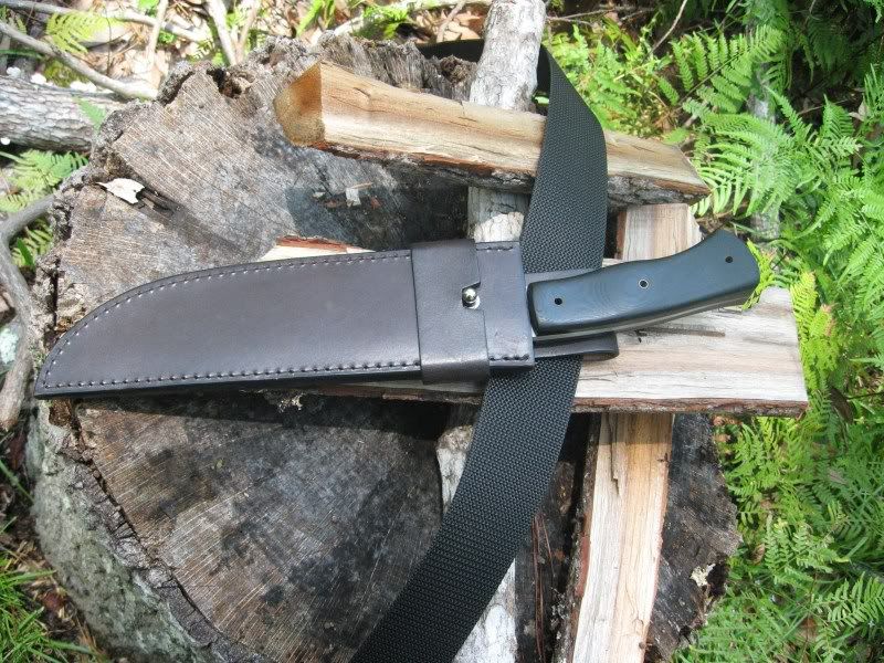

The knife came with a lanyard (which I have misplaced) and a nice leather sheath that slips into a handy belt frog.
One of the things that impressed me with the Browning was the superb balance and feel of the knife. It balances right at the plunge line of the grind, has a distal taper, and even a tapered full tang. These features are usually only found on expensive customs.

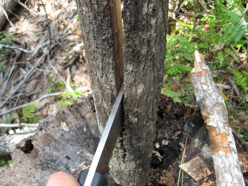

Next up, some baton work and slicing.
It has been hot, humid and very wet here lately. Finding some wood dry enough to start a fire sometimes requires splitting some wood to get to the dry stuff.
While not exactly a Mora, I managed to get some slices of dry wood thin enough to light with my Bic. A knife like this is a real friend when you need a fire in wet conditions.
This Browning is a superb handling big knife, lively in the hand and easy carrying with minimal bulk. I like this knife. It's a lot of knife for the money.
