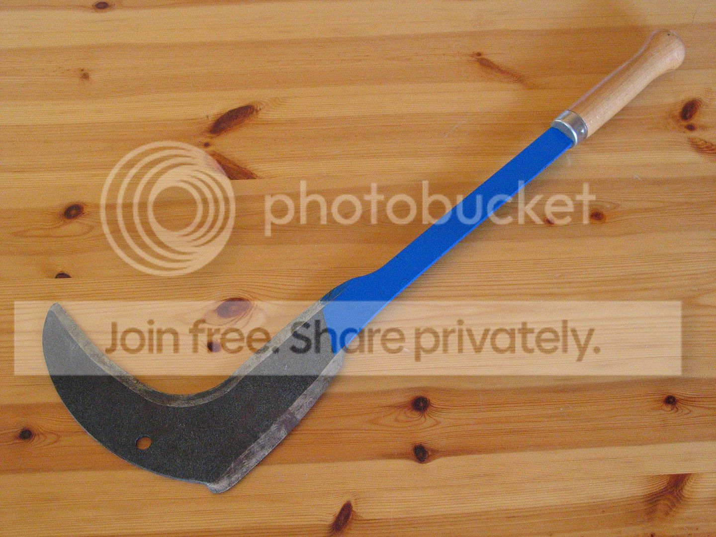

I have the Mini Duku Parang which is the same except it has a wooden handle. It's my favorite small machete : light, handy, easy on the hand and delivers a healthy wack with some skills. Condor has many models of this size that could match your needs. However, in my experience (and that means Mediterranean forest), brush clearing is best done with a short billhook (the italian version is called "roncola") and even better with a long handled billhook. It's a very versatile and efficient tool. 42Blades probably distributes these as he has tons of very efficient brushclearing tools (including italian and russian brands), you should find something up your alley. Rightaway, my good old billhook which I used for absolutely everything from campsite clearing, tent pegs pounding, digging out stones, cutting up meat, hacking vegetables to cutting and splitting firewood, you name it (except cleaning my nails...)
And here my long handled billhook (the most recent, but they haven't changed in 40 years) :
You want a billhook or a manaresso (an Italian class of chopping tool that's like a cleaver made for wood.)
