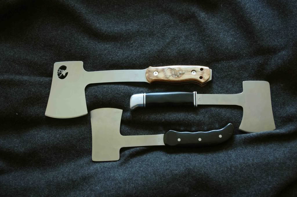

Here's one that is different... This is the only one I've seen... Maybe some one can tell me more about it...
It came from a ex-Buck-employee... Thanks
106 Duck...

I wonder if ITEs un-buffed axe is a DU model. Anyone see a polished model with a DU Duck head cut-out at a dinner or DU mag. 300

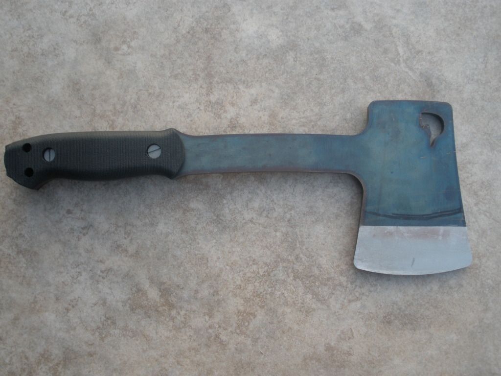

I've been envious of that Duck cutout axe ever since ITE displayed it on a Sunday Picture show. The Kydex handled axe was only used in 1999 & 2000 which gives us an approximate time frame. I had previously diligently searched the projects lists and can find no DU set including an axe. I think most telling is that it came from an ex Buck employee which may be a clue that it is a one off, perhaps a sample that never made it to production. That's a bummer because it suggests I'll never find one for myself.
When I saw it I wondered if it was from a 'lunch box of an ex Buck employee'. As no others exist. DM
