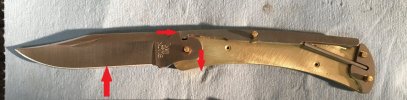

Just to add that lock failure is about more than accidental closure.
The other issue is wear and tear from hard cutting forces. The basic lock back design typically has a bit of angle on the interface between the blade and the front of the lock bar. Hard cutting forces can cause the lock bar to lift. This can be felt by holding your thumb on the top of the joint under very heavy cutting. Most lock backs from pretty much every maker will do this. It's just a matter of the design.
Still, some are much worse than others. Glassner at Syoderco claims that kickbacks shouldn't be made from stamped steel like 420HC because a) the stamping causes small deformity at the edge of the part and b) fine grained steel is too maleable even after hardening. Combined, this leads to what we call "lock rock".
Cold Steel eliminates this problem by addiing a stop pin to stop the opening movement of the blade. It's s good design.
All of this assumes that the pivot sssembly has no slop. Every Bucklite Max and Spitfire/Slimline that I've tried get sloppy very fast.
i should also note that lock rock can produce an accidental closure in a sling shot type event like cutting through a branch. The hard cutting force can lift the lock bar and when the blade cuts thorough the branch, the inertia can cause the blade to snap closed before the lifted lock bar can return to location. Many people have reported this kind of closure.

Sorry Pinnah, but I respectfully disagree...
It's simple geometry, really. The pivot pin is ahead of the lock bar. Any forced pressure on the cutting edge wouldn't raise the lock bar if the pivot was sloppy, it would do exactly the opposite and the lock bar would fall below the bolster, not rise above it.
Additionally; the blade stops rotating when it meets the lock-bar. At the same time, the lock bar engages the notch in the blade.
Really, there's not a whole lot that can go wrong with this design. If you have a 110 that is experiencing this, it should be repaired or replaced.
I've used and abused dozens of different 110s and have had dozens of them apart. From some of the oldest to some of the newest, I've not witnessed enough erosion of the parts on any of them to cause a serious failure.
I'm going out on a limb and guessing that 100% of the blades are harder than 100% of the lock bars. When that's the case, the blade could (and should) wear the face and locking tab on the lock-bar. Is this erosion enough to measure and effect the locking mechanism? Perhaps on a knife that is opened and closed a lot, but for these parts to deform from hard use; I ain't buyin' it.

And I would assume that is the reason that you sometimes see the blade of very early 110's, usually first and second versions, canted slightly upwards when opened?
