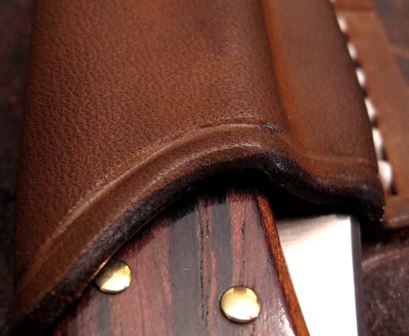

So back to the tale of the wayward sheath, I started this sheath
when I returned from a business trip and I got carried away when
I shaped the drop down opening area, I usually mark the thickness
of the handle onto the sheath, then do a soft curve down to make
it more attractive than just a straight opening, this being on the vertical
sheaths, not the horizontal, just works better and looks better on the vertical.
I thought after I started shaping the leather that it should not have gone down
as far as I did, but figured with the 110's excellent history of fitup, a little bit
wouldn't hurt and once sewn up, it did fit well, but not as strong as I liked and
so I slashed that sheath in half, I call it a commitment cut
once done there
is no fixing that!
Here are some shots of the first sheath, the edging was not finished, as I waited
to see how it fitup after final stitching was completed;

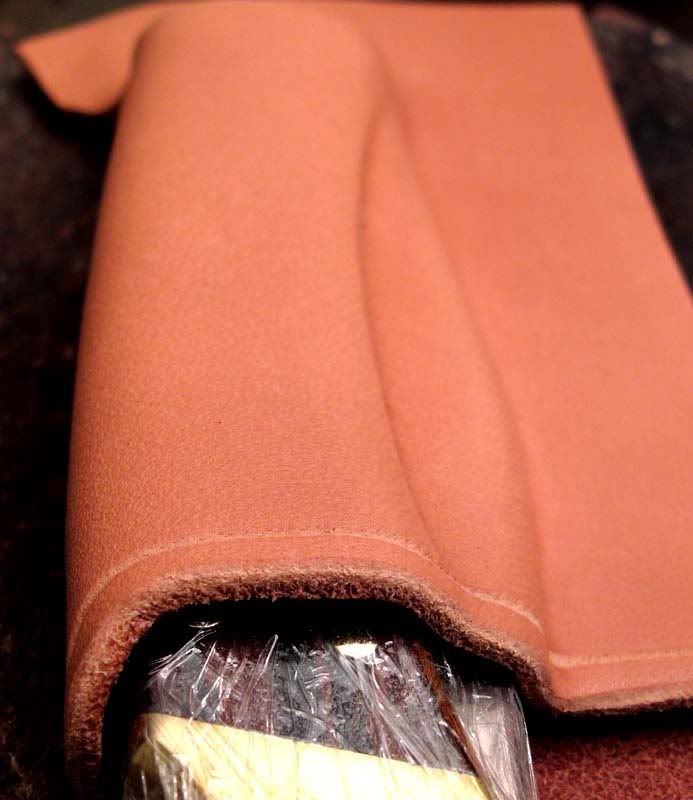

and here is the new one I'm starting tonight, you can see the curve doesn't
drop down near as far;
side shot of the first one, with the lower half slide on, seems weird to see that
and a side shot of the new one, you can see here that the leather now
comes up higher and over the peak of the blade's spine, which will provide
very secure retention;
some extra shots of the first one, while it still worked and held the knife
I just wouldn't let it go this way,
and a looksee down the throat of the bottom half, you can see that I also
shape the bottom portion of the sheath to better fitup the knife to the sheath
I've seen a lot of 110's and each seem just a little bit different than the next
so I always need that person's actual knife for the fitup
So the story ends, becareful when you start cutting the leather!
