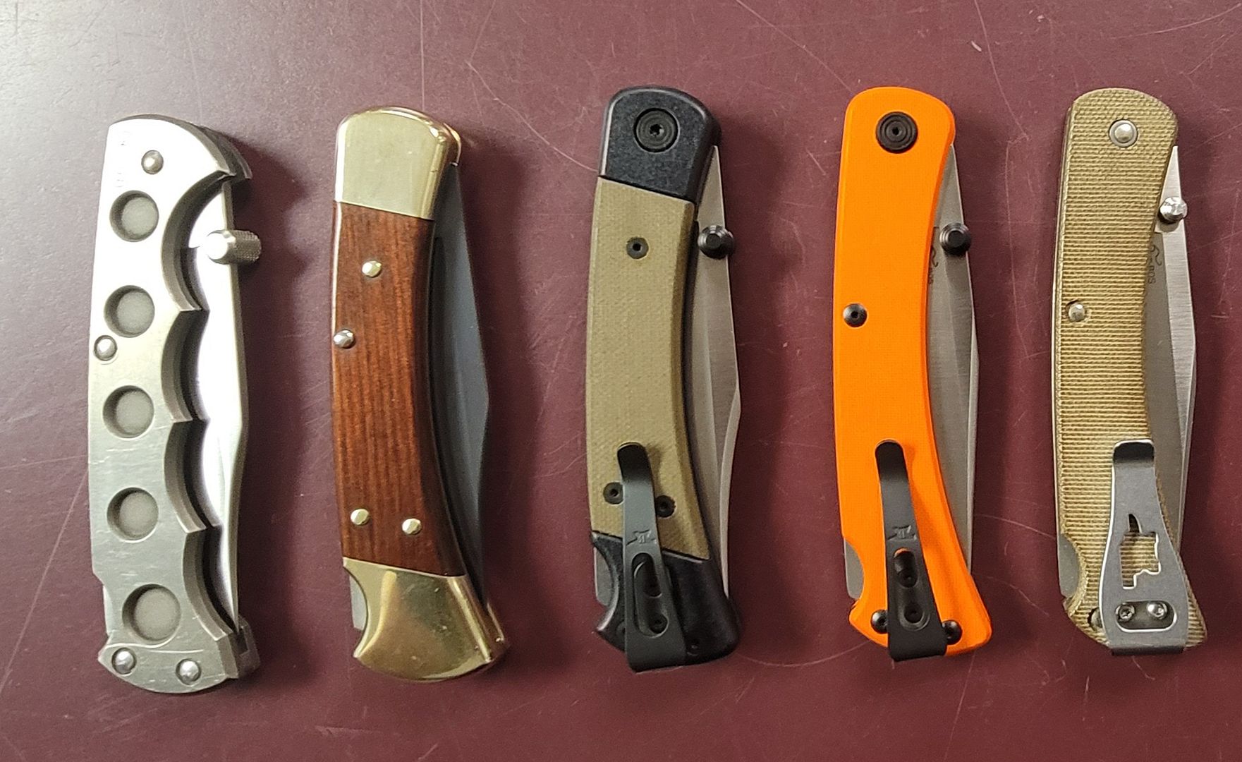

Here's what's in the photo.
Brass, cherry, and CPM-154
Standard fair 560 with flick-it stud
Micarta Slim Pro
110 Slim Pro TRX
110 Hunter Sport
My bias: flog me if you must, but I'm not a fan of screw together 110s. Not even the original 186 which is the benchmark that current models don't come close to.
Shot of the group

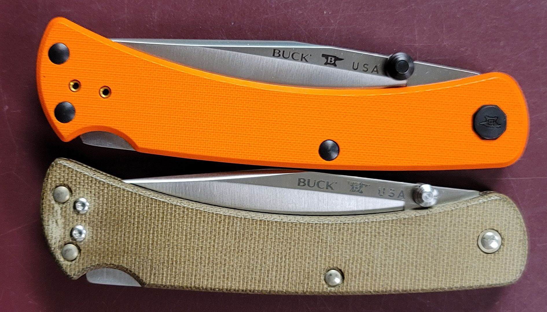

Sticking to the Slim Pro and TRX

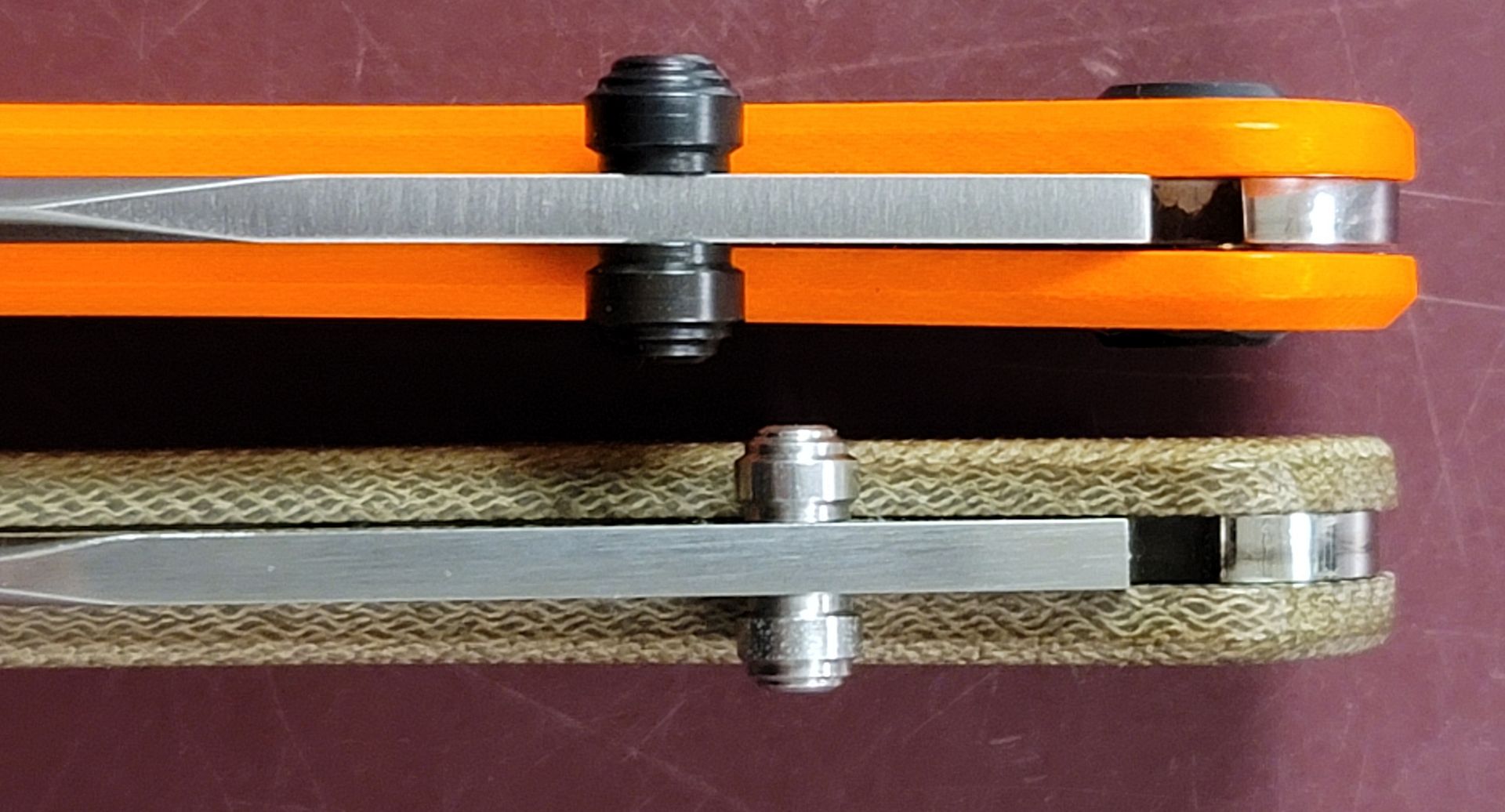

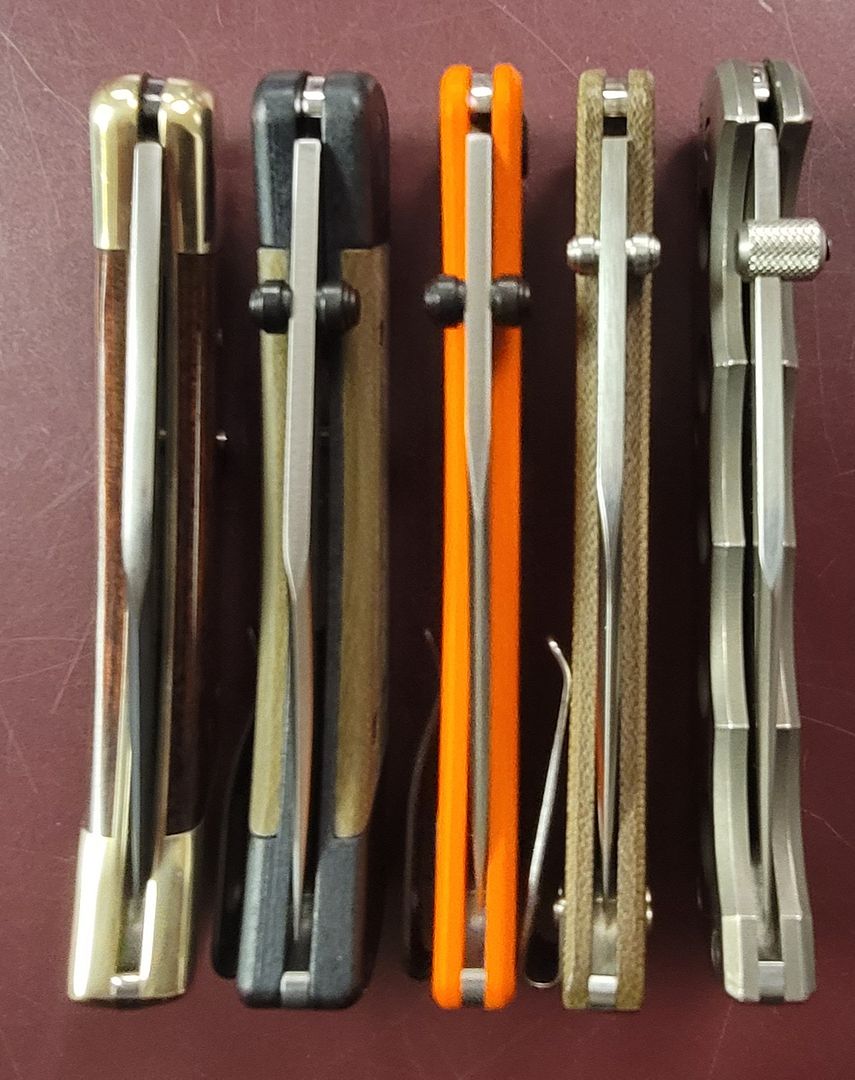

Notice the size and location of the studs
Not damage to the Micarta, it's mud and I was too lazy to clean it up.

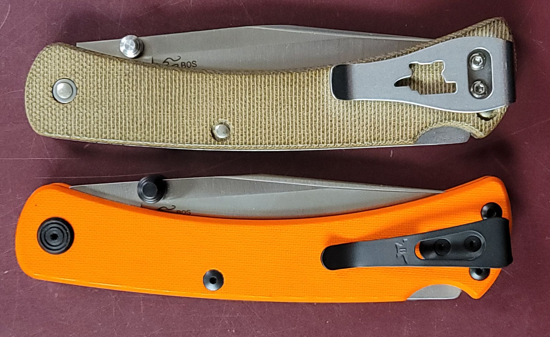

Notice the nice brass inserts in the TRX? You can't see the inserts in the Micarta because Buck was nice enough to fill them with screws so you won't have to clean them out if you want to switch the clip.
Pocket clip side

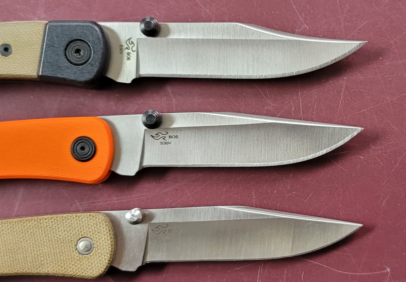

Blade shape

Thickness. .39" .4"
@ stud. .46" .54"
@ the pivot .39" .48"
@ pocket clip. .65" .6"

I think I like the Slim Pro's pocket clip better. The new one seems a little light for a heavy use folder.
I could pinch the micarta together in the blade channel more than I could the G10, but that was expected and not likely an issue for the micarta.
You can see from the first photo where I put the thumb stud on my 560. Turns out it's the same place as Buck put it on the Slim Pro. It's less likely to be in the path of a cut, but still serviceable. Nothing wrong with the Sport or TRX location, but I prefer as close to the pivot as possible with retaining it's function.

Unfortunately, the pivot screw on the TRX is thicker than the handle. This means potential hangup on pocket if you wear jeans that you refuse to admit no longer fit, like I do. It will be interesting to see how the Cerakote holds up on the screw head after a couple years of use.
Personally, I like the Slim Pro better and not just because of my pinned construction bias. I don't feel the TRX is an upgrade from the Slim Pro. They missed on a couple of things: protruding pivot head, pocket clip, stud location, stud size, and open holes for the pocket clip.
Micarta Slim Pro
110 Slim Pro TRX
110 Hunter Sport
Shot of the group
Pocket clip side
Blade shape

Thickness. .39" .4"
@stud. .46" .54"
T the pivot .39" .48"
