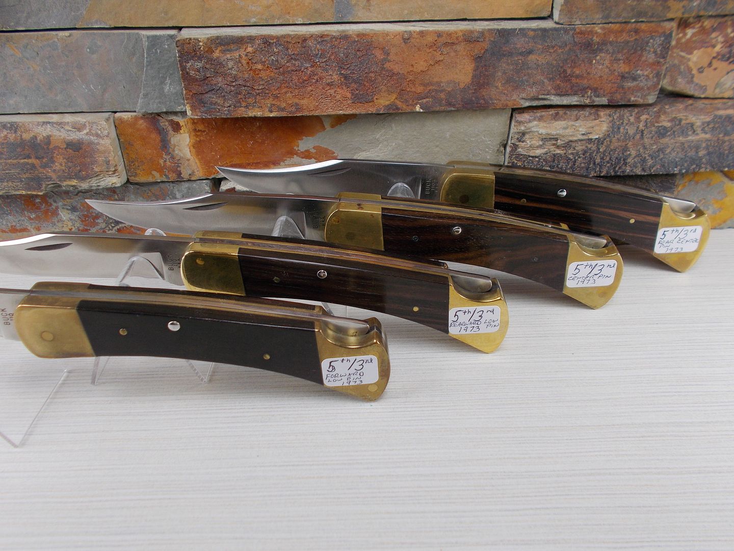

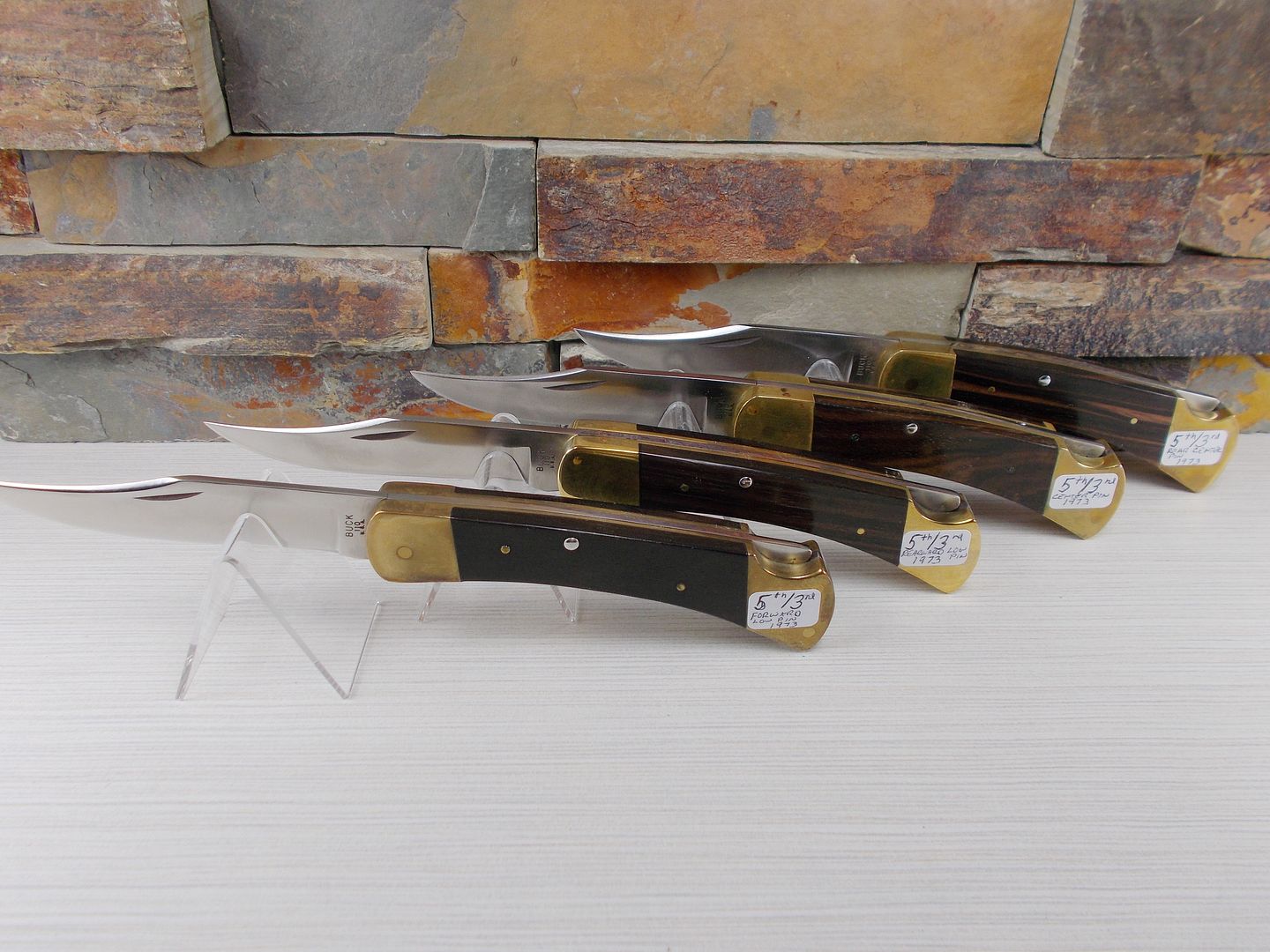

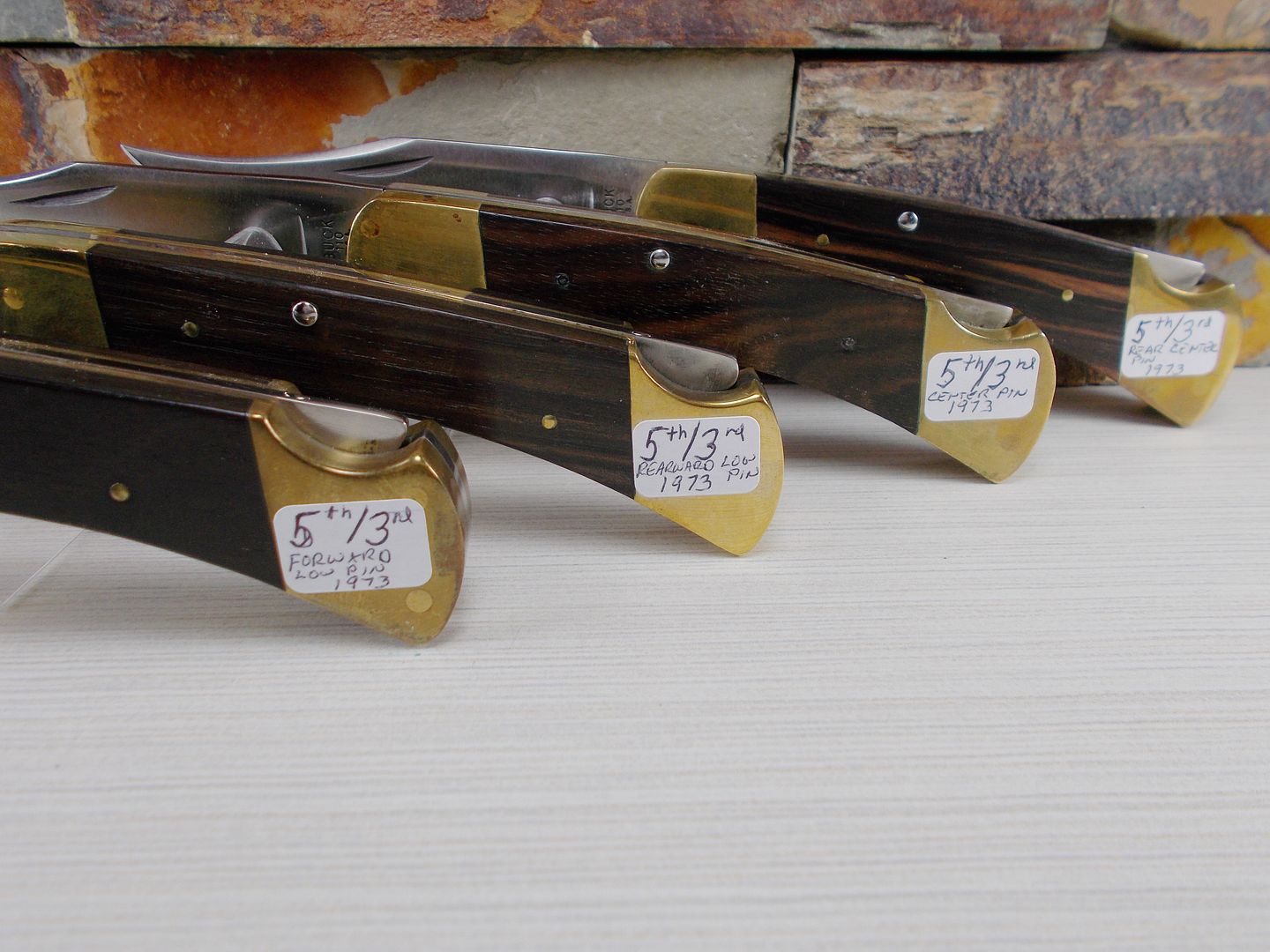

I took new photos this morning of the four 5th/3rd knives from above.
They are now in order of age starting with the oldest in front, progressing to the youngest in the rear of the photos.
The oldest (front) 110 has a forged brass frame made by Revere Forge. (the rear offset handle pin is further forward than the next change) This knife was the last of the 110 frames forged by Revere Forge.
The second 110 was made by a contract forge company that only forged brass frames a short time before Buck switch to the sintered brass frames. (not even Joe knows the name of that company)
The third 110 was the very first of the sintered frame 110s which Buck still uses today. The rear pin is now centered. These knives took on the squared stocky feel of the 110s from that era.
Buck still glued the ebony and ground the inside of the frame, then…..
On the fourth 110, Buck figured out the glue and grinding was unnecessary on the sintered frames because they were so precise in geometry. (rear pin is still centered)
There were no more gaps left to fill with glue that had been normal between the forged frame and the ebony.
George said that the production of the fourth knife went into early 1974.
That's all I was able to remember. Hope I got this right George….and thank you for the help! :)
