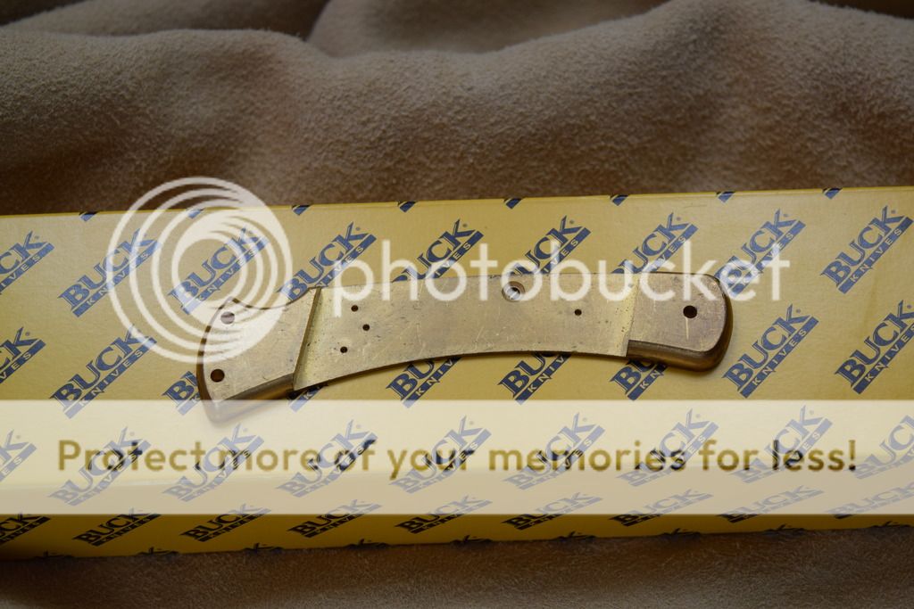

I was given this some years back by an individual who rep'ed or consulted for a foundry that suppied Buck. It's puzzled me for some time because it has the four holes for the pins ,yet it's edges are beveled. Preston
By the time the Two Dot knives came along, the frames were made of sintered brass supplied by Pacific Sintered Metals. If you look at a lot of the Two Dot knives from after the 4 scale pin version, you'll find that the frames were drilled for 4 pins, even though only 3 were used. I haven't really looked, but I would guess that carried on to even later versions, including the Four Dot knives.
Bert
That's all they were doing was filling the holes as the frames came with those holes in them. (correct)DM
When did they start to bevel the all edges? I know I have a four dot, finger groove that just the lock notch is beveled. Thanks, Preston

I don't want to derail this thread, so if this photo is out of place, I'll edit it.
You have something there that I have not seen before.
There are lots of examples where the fourth hole was in two dot frames and not used.
I've not seen any in the later two dot frames...so to see the fourth hole in a four dot or later frame is really something!
That's not even the first of the four dot frames as the thumb press has a radius finish.
I'll send your picture to George Stinsell and see what he might be able to add if you don't mind.
Please do, as I said, I have been puzzled by this and did not have the knowledge to ask the person I received this from. Preston
Preston, Buck began to hand radius the edges on a 112 in the 3 dot era and on a 110 it was in the 4 dot era. Off topic. DM
Okay...I got an answer from George and it makes perfect sense to me now that I hear it.
From George;
"The square frames had a different drill Pattern than the rounded frames.The early rounded frames were used in production and custom shop.If you take notice a lot of 4 dots and later, that had say, a stag handle, they used two large handle pins.one at the front bolster and one at the rear bolster.Rather than two at the rear bolster.I hope this helps."
George knows more about the 110 than anyone I know, so maybe one mystery is solved.
David I probably have derailed the OP's topic and I apologize. He ask what version and variation his knife was. The topic included discussion of pins and pin placement. That's where I ask about the radiused frame I posted aabout with the three rear pins. HTH, Preston
