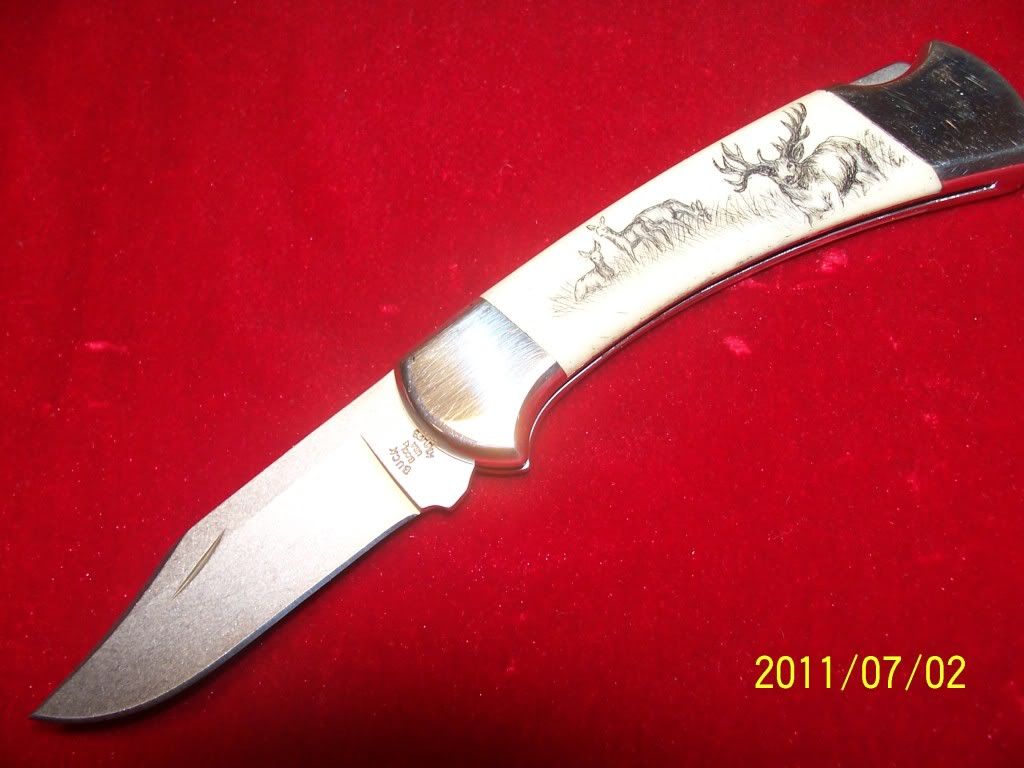

Here is my Limited Edition 112 with satin finish S30V blade and cow bone slabs, (scrimmed) with nickel silver frame. DM
Then unlike JB's, my Limited Edition, ram's horn 112 has a brass frame and a 440C blade. DM
WOW! Beautiful 112's you guys have!

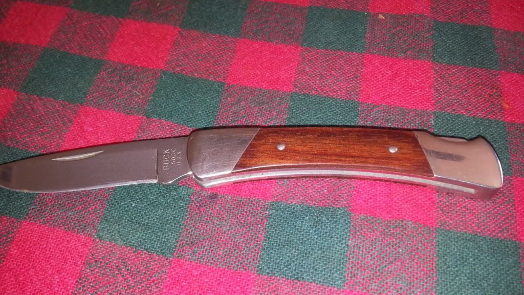

You want a Buck 500 series knife. 500 Duke, 501 Squire, 503 Prince, or 505 Knight. Stainless Steel bolsters, at least up thru the late 90's. You can think of the Duke as a Stainless Steel bolstered Ranger with a drop point blade....... :)
Wow, I learn something new here everyday!
I had to go check the date on this 503.....now I am going to pocket carry it the rest of the day :)
The bad news is now I want a 500, 501 and 505 to match it :(
