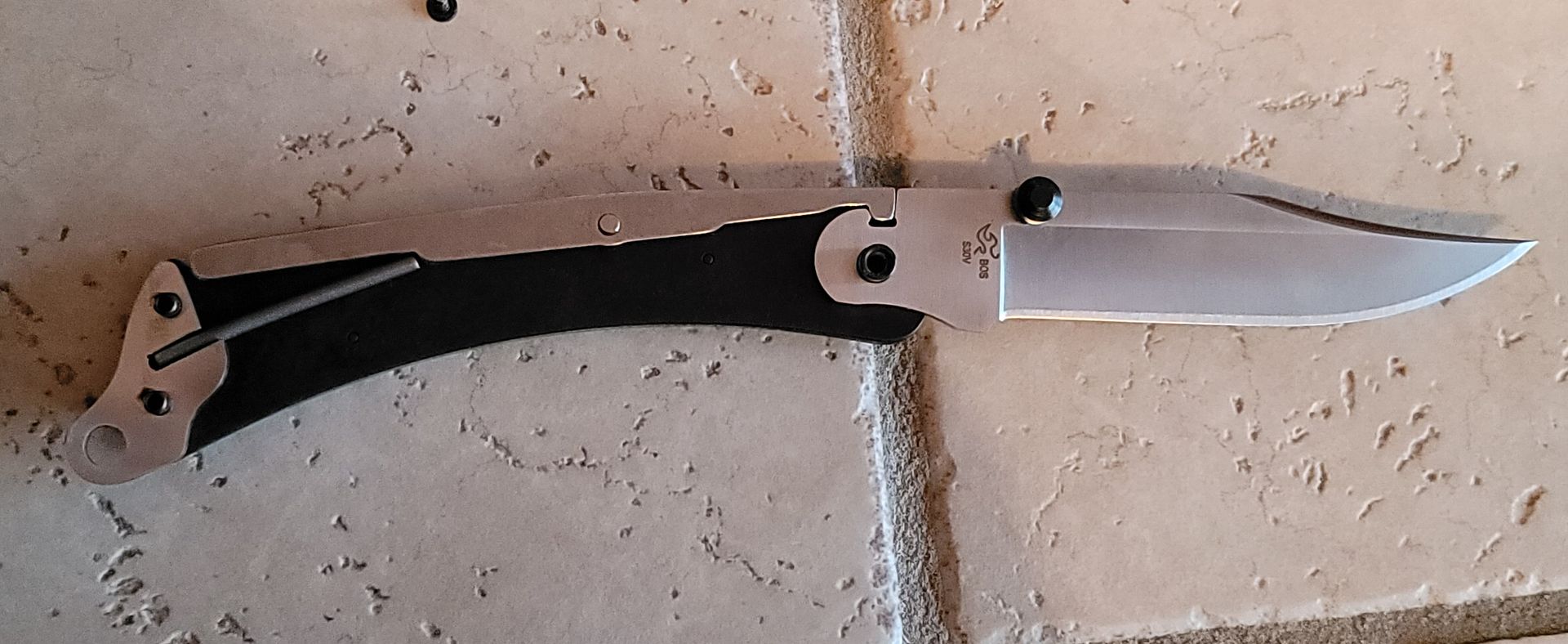

I purchased a Ranger Sport recently and wondered if any other owners had taken the knife apart yet. A lot seems to have been said about the screw together construction but I can’t find anything that shows the knife disassembled.
It looks simple enough but just wondering if there is any complexity in putting things back together again.
My question would apply equally to the 110 Hunter Sport.
Apart from general curiosity, I am interested in what might be between the frame and the rocker bar. On my knife there is a distinct gap between the bar and the frame (non pocket clip side). The gap is not noticeable on the other side. When I hold the knife up to the light it looks like there might be spacer material extending for about an inch between the bar and the frame. Tried to take a pic but couldn’t get a decent one.
Anyone else notice the same thing?

There's nothing between the frame and lock bar.
When you take it apart, be careful not to lose the lock bar pivot pin. It's not fastened in place and it's about 1/4" long, 1/8" diameter and will disappear in carpet forever....lol
I think you should see daylight between the lock bar and the frame, either on one or both sides of the lock bar. The Frame is Cerakoted so if the lock bar and the spring holder and blade bushing were all the same dimension, there would be binding on the lock bar and wear on the coated parts.

OK it got the better of me and I took the knife apart.
Disassembly was straightforward.
Putting it back together wasn’t that challenging but getting the rocker bar pin back in was fiddly.
Pleased to report that I have no leftover parts and the knife functions as before.
What I could make out inside the frame before taking it apart was an accumulation of oil. Combination of dark colours and my old eyes thought it was part of the frame. Once apart, I wiped it out and now all is clear.
Some pics below might be of assistance to someone.

Should be 24 loose pieces.
I know... it's not fully disassembled in a pile, but the only photo I have, I think.
1- blade assembly (w/ stud and bushing)
2- rear frame screw male
2- rear frame screw female
1- pivot screw male
1- pivot screw female
6- handle screws
1- pivot pin
1- left frame side
1- right frame side
1- left handle scale
1- right handle scale
2- pocket clip screws
1- pocket clip
1- spring holder
1- spring
1- lock bar
