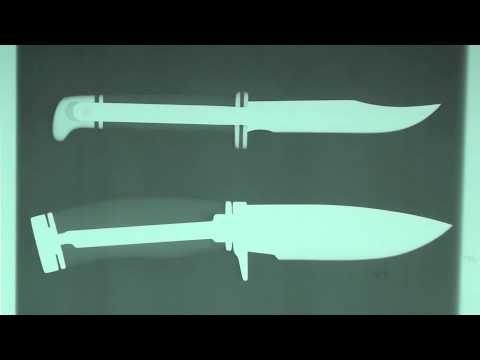

Had a little fire in the back yard the other night, and decided it would be a good chance to try batoning some dry fire wood with my Buck 119. This was possibly pretty foolish on my part, since the knife is clearly not designed for that. It broke about a half inch up from the hilt, not half way through the first log.
I believe this knife was at least 25 years old, as my father had had it since before I was born. Also might be worth noting that I was using a softwood branch as a baton. Not a good first batoning experience.
Anyway I just thought I would share for anyone interested, I have seen some threads in the past where people were wondering how the 119 would do for batoning. Below is the link to a pic I took of the broken knife, let me know if anyone has trouble seeing it!

Its a rat tail tang knife with a super thin hollow ground edge. I wouldn't expect it to break from a little light batoning, but I am not too surprised by it either. That was clearly beyond its intended use.

And I would say Buck tangs are not rat tail, I would go as to define it as full tang.
this is the 102 tang, on the top
My Buck 102 :D
It's somewhere in between rat-tail and full tang, not quite either. Anyway, the point of failure had nothing to do with the tang? I wouldn't expect a Buck or any quality brand to just snap down the middle like that, especially if the poster is honest and was just doing light batoning. I would like to think it's an issue with that specific knife and not the design. I would think Buck would replace this for you under their lifetime warranty as this is most likely a lemon that was simply exposed through abuse. It's at least worth a call or email.

This is sad. I doubt it was a defective blade as 155440 suggests.. it has lasted decades of use as it was... and just now failed during batoning. We don't know that it was "light batoning" as the OP has not said as much. Could have been using that soft wood baton to whack his 119 into solid, dry-aged oak for all we know. I have oak floors in my house.. that stuff is like concrete.

To answer ocnLogan, this was indeed my first ever time attempting batoning.
Also, it was light batoning , I have no picture of the wood as I burnt it.
It was a very poor decision in hind sight, I'm new to this and tend to learn things the hard way. I immediately regretted what I had done, would have been nice to pass the knife on some day , but I will say this particular knife didn't have much sentimental value to either me or my father. I imagine he will be much less sad about this than I am . I have axes and hatchets that i usually use for this type of thing, but had just "learned" about batoning and figured I'd try it. Curiosity killed the cat this time.
