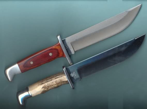

How are the Buck 124 Frontiersman models constructed - more specifically, how is the guard attached? I've wanted one for years, and finally got a 2012-made 124 this week. Looking at the tang, where the green micarta butts up against the guard, it looks like the tang is the same width after it passes through the guard, to area of the tang stamp.
On the 119 Special, the tang is a stick tang, and the guard butts against the blade and then the handle is put on over the tang, with the handle material "holding" the guard in place, so to speak.
So, how is the 124's guard attached? If it got hit hard enough from the grip end, could it break loose and slide down the blade? I know this is probably trivial, but I'm curious. Mainly I want to make sure that if I modify this one like I did my 119, I don't mess something up. (I reduced the guard on my 119, and drilled it for a lanyard.)

Yes, some (early ones) had the hidden tang construction. Now, they are built using a 'full' tang construction but the handle portion is a little more narrow than the blade. DM

The hidden tang 124 is in the middle.
Top 124 full tang.
All of these 124s are hidden tangs.

Ok just to add to the discussion, there must be a detent or something to keep the guard in place, if you look at say the 124LE, the blade portion just behind the guard and just in front of the guard is the same width, so the OP was asking how does it stay on, I think there is some kind of a detent just under the guard but that makes me wonder how did the guard get put on if just that portion is not as wide?

On an 80's era 124 that I had you could faintly see where there was 2 pins that held it in place.
Beat me to the answer.... 3 am.... ?? :o Yes they are pinned to the blade thru the edge of the guard. It'll be tough to photo, mine are polished in pretty good. There is no shoulder for the guard to rest against on the full width tangs. The 124's with the stag handles have stick tangs and the guard is pressed against the shoulder like a 119.
Ok, here is a quickie picture done sitting here at my desk with a "breath fog" of the edge of the guard.
Played with the contrast a bit. You can clearly see the two pins. This particular knife is a 3-line pre date code.
My current production 124 (2012) is also pinned.

DeSotoSky - that's exactly what I needed to know - thanks! I'm curious though - do you see the pins on the other side of the guard? I can see the pins on my 2012 #124, same side as the one you have pictured, but I don't see them on the other side.
So I guess the pins don't fully penetrate the guard - just through one side of the guard, through the tang, and into the guard on the other side, kind of like the butt-cap on the standard Kabar #1217.
Either way, knowing how the guard is attached settles my question. Thanks for all the effort & input everyone.
