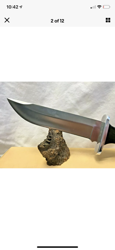

Hi guys, I have an awesome buck 124 that's pre 1986 as there's no date code. What was the steel used for this, anybody know? 420? 425? Thanks!
josh
425m is a good steel. Won't hold an edge like 440c but between 440c and 420. Plus, those have a full hollow grind.

I have a 124 that is dated 89/ and it has a fuller hollow grind. Not the earlier semi- hollow grind. Which helps it cut better. DM

Thank you here is a picture of mine in this link, can you tell me which one mine has? https://postimg.cc/jD7B7YfL
Here are a couple of photos of 124s, an older one and a newer one. Hope they show what David is talking about...
