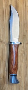

If you are going to keep doing this, you need to get a belt sander and forget the grinder.Seeing those clip points above has given me an itch to pick up another 103 and head to the grinder. I need more practice.
You can eat Ramen for a week, sell blood, plasma, a kidney, whatever you feel is appropriate. I just remember your posts on trying to use a file when modifying your 103. A 1x30" belt sander isn't that expensive and I have found that I use mine for so many things I never thought about before I bought it. You can get good with the sander and start charging people to sharpen their knives. Think of it as a business expense for your new knife sharpening/knife customization business. While your knife looks fantastic, I have found that it is really hard to control a grinder for this type of work.Clarify: I should spend "knife money" on something that isn't a knife? I'm sure you didn't mean that.
You've got to stop sounding so reasonable.You can eat Ramen for a week, sell blood, plasma, a kidney, whatever you feel is appropriate. I just remember your posts on trying to use a file when modifying your 103. A 1x30" belt sander isn't that expensive and I have found that I use mine for so many things I never thought about before I bought it. You can get good with the sander and start charging people to sharpen their knives. Think of it as a business expense for your new knife sharpening/knife customization business. While your knife looks fantastic, I have found that it is really hard to control a grinder for this type of work.
That looks really good to me. I like it. Please provide details on how you shaved the knife down. Also did you lower the tip any or is that the tip location from the original 103?This were I’m at.
