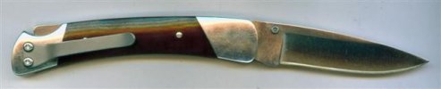

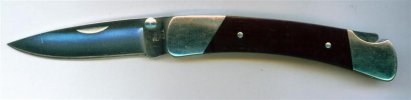

Thanks. Even though I do this kind of thing I mean no disrespect to Buck or collectors of their knives when I do it for customers knives or my own. Its sometimes hard to justify modifications for me on one thats been discontinued for whatever that is worth but who am I to tell a customer what to do with his or her user folder you know? I just do the work on others property.
Now on this model. This one I happened to like the mod enough to do one for myself on one of my own 501 folders, but I did it to one of the Squire models still available.:D I still cringe when I take one of my own knives or even a customers original knife that is not made anymore and go to drill a hole in the blade and body to modify one but sometimes the mod is the diff between a knife sitting in a drawer or a safe and one thats back in the pocket and being used. That was the case here because this 501 sat in a box in my safe for the last few years until I updated it. Personally I think a small lockback is better off up high using a pocket clip vs deep carry because of the havoc pocket lint can play on the lock mechanism. Just my opinion though based on experience of how many folks have sent them to me with locks no longer working when all it was was pocket lint jammed in the lock notch.

STR, would you mind posting a pic of the mod of your 501? Love to see it...Mike
Well, tried but its already posted in my forum so its not going to let me do it twice.
Actually the one posted at this link is a customers but mine looks just like it except mine is a newer model than the one pictured. Otherwise there is no difference. I still had the customers knife and my clip and thumb stud are identical to it. http://www.bladeforums.com/forums/showthread.php?t=571847

STR, I took the liberty of posting your photos here. (Let me know if I dun' wrong in doing so and I'll remove them).
Very nice mod. Now I gonna go over to your forum and spend some time reading up......Thanks, Mike

Not a problem posting the pics here. I'd have done it but my third party site was down all day yesterday. Just saved me having to do it this morning so thanks. :thumbup:
