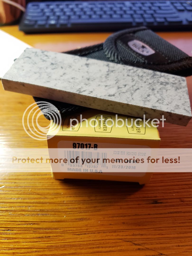

Product Info for Buck Knives Soft Arkansas Stone Knive Sharpener
Keep your knife razor-sharp with a high-quality sharpening stone. Whether you own a pocket knife, a hunting knife or a kitchen knife, a sharpening stone is essential for preventing your blade from becoming dull. Most of our sharpening stones are lightweight and portable, so you can use them at home or take them with you wherever you go.
Specifications for Buck Knives Soft Arkansas Stone Knive Sharpener:
Fabric/Material: 100% natural Quartz Crystal Novaculite stone
Additional Features: 500-600 coarse grit
Size: 1-5/8 x 4-3/8 in
Included Accessories: Includes Black nylon sheath
Mak, that's a good photo of that stone. Thank you, DM
