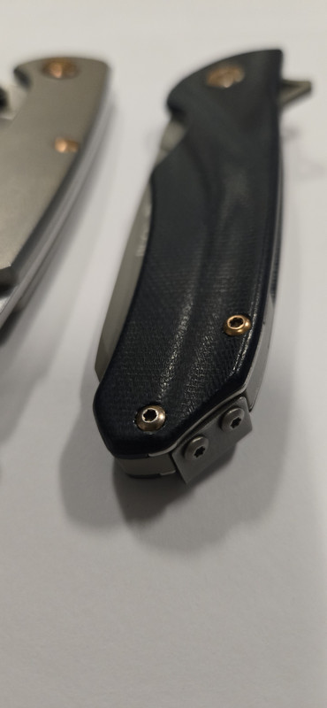

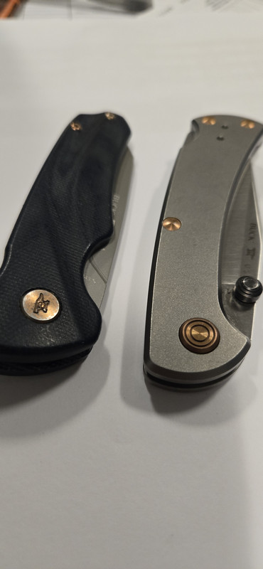

I bought the 843 BOTM last month, and I love the knife even more than I thought (liner locks & flippers not really my thing). I've carried it more days than not since getting it.
But, I have issues with the hardware... From my understanding and experience, PVD coating is very durable.

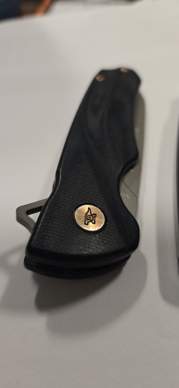

The 843 info says it includes "bronze PVD-coated fasteners". Same as the slim TRX Titanium 112/110 Legacy models. But on my 843, the bronze is already wearing off. The pivot is wearing all around the edges, and the body screw at the end of the handle is pretty much entirely worn through. It reminds me of how cerakote wears.
As a comparison, my 112 TRX Titanium, which I've owned for about 6 months, and has gotten more pocket time/use than what this 843 has seen, still looks the same as new. If anything it looks like it's patinaed even a bit darker.
Is it a thinner coating? (Not sure exactly how the PVD process is done), or is it not PVD at all? It honestly reminds me of that coating on cheap "bronze" cookware that quickly wears off.

Yeah, I don't expect a coating to last forever, but especially compared to the Legacy 112 I have, I guess I expected it to last longer than 3 weeks. I would have been better to anodize it a bronze color.
It's funny, I'm not a big Cerakote fan, and this has a Crekote coated blade. Even that spine and the flipper tab that gets constant wear rubbing in a pocket still look brand new.
The wear on that pivot “T-Nut?” looks typical of an air dry, dyed lacquer. Even bronze plate would wear better. Some PVD (Physical Vapor Deposition) coatings such as TiAlN have an HRC of 92. This is much harder than say the blades they are applied to. I know of no bronze colored PVD coatings. PVD coatings tend to be ceramic in composition and performance. You can’t anodize steel, but Ti and Al lend themselves to relatively hard anodize coatings although these coatings are thin and brittle and tend to fail because they are applied over soft substrates.
