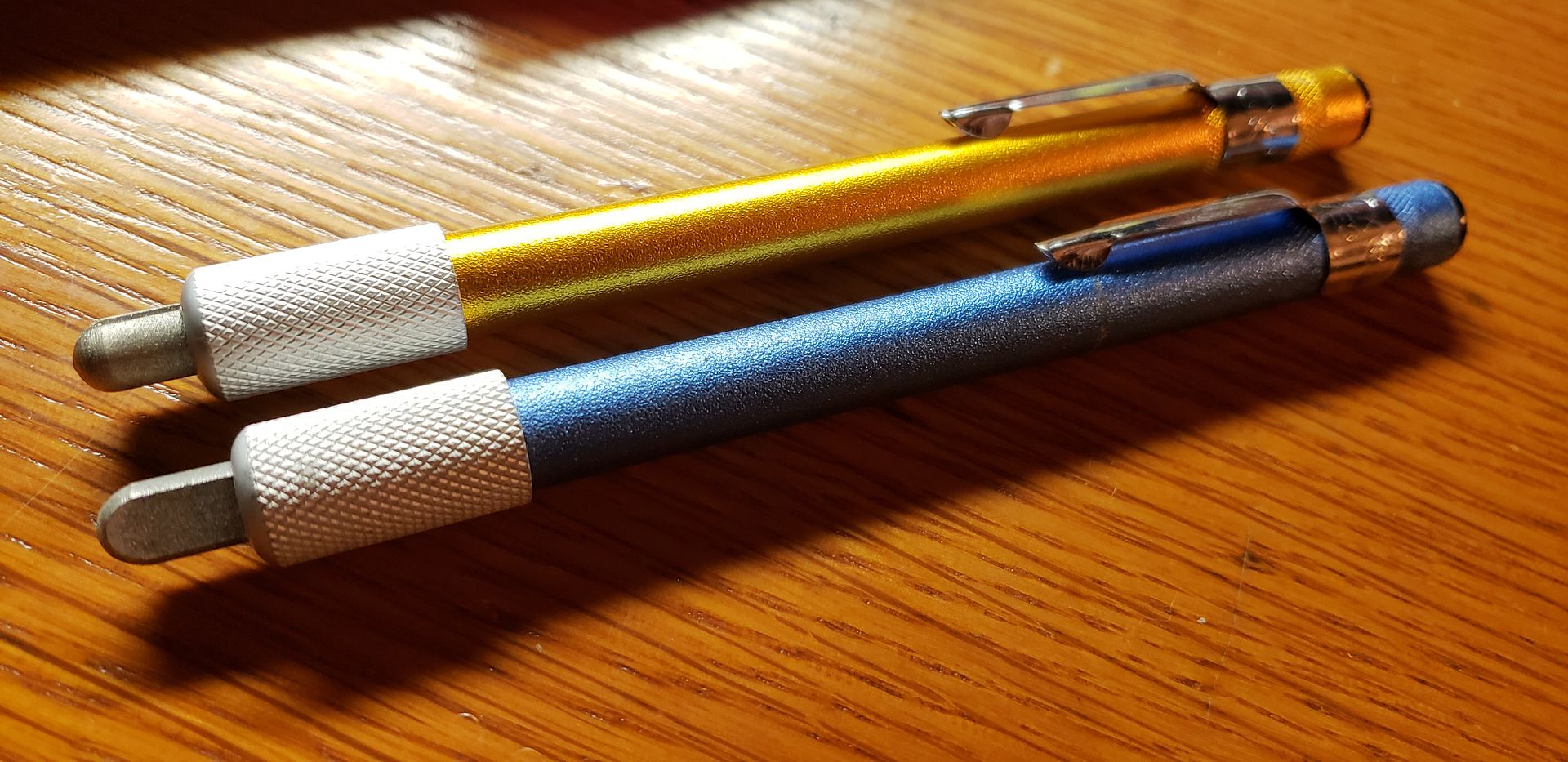

Here is a pic of the sharpener.
Mak, that is it. I have the blue one, on the pocket clip it says Smith's. Thank you for the photo. DM
The tool that Mak shows can take you a long ways out in the the deer woods as well. They are cheap and I recommend getting 2 for around
the house and 2 for outdoors. DM
