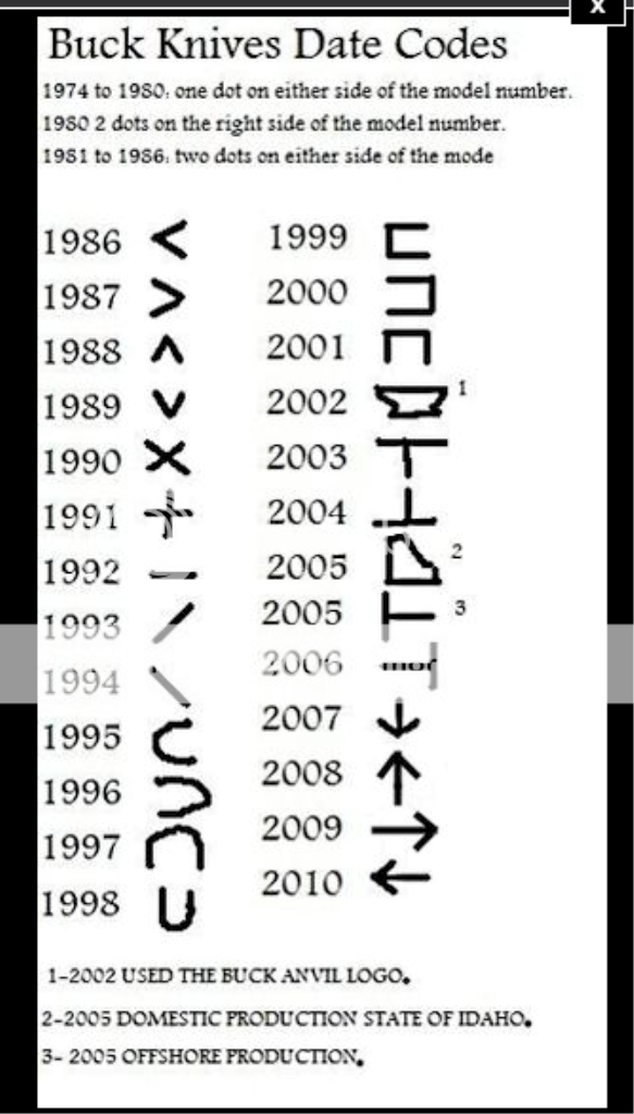

I've read the following from other sources and was thinking this would be a good place to either have it confirmed or corrected.
early Buck knives made up to 1968 were marked on the reverse side only with the name (Buck)
1968-1972 knives were marked (Buck, USA) two lines.
1973-1981 knives were marked (Buck, the knifes model #,USA) three lines.
1982 to present marks were added to the knife to indicate the specific year of manufacture as per this thread.
I've heard all kinds of different stories on when Buck knives where marked with what. The above seems to be the most consistant story but it would be nice to be sure.
The 1980 info on the diagram to the right is incorrect in that it says the Three-Dotter has only two dots to the right of the 110 stamp......does not mention the dot to the left.

Just a note.... These codes are not mine...They came from Buck.
I just stuck them here for everyone to have quick access to.

Attention, Attention, Attention
The dot information at the top of the chart applies to 110/111/112 family of knives only.
Other Buck knives are seldom dated using a dot system.
They are dated by how they and with what they were made and by the code system after 1985......

Recall the "script BUCK" used in the mid-70's into the early 80's.
It appeared only on non-110/111/112 families such as the 700 series.
Are there any 300's with script?? If memory serves me, the earliest
300's are Schrade built and then Camillus took over in the 70's....do I have that right??
Well, I went back and looked at my 110 / 112 from the years, and low-n-behold, here
we have some Buck Custom shop pieces with "script-BUCK" on the blades. That shoots my earlier comment down as they are 88's thru 92's (when purchased new).
Buff, The old English script stamping you refer to was also used on the 500 series from late 1970's thru 84 . DM

Okie, I didn't read this until now but welcome . Buck began using the Anvil stamp on knives in 2003 perhaps some one year before but to show it as a LE or custom this stamp was adopted and continues in use today . DM
