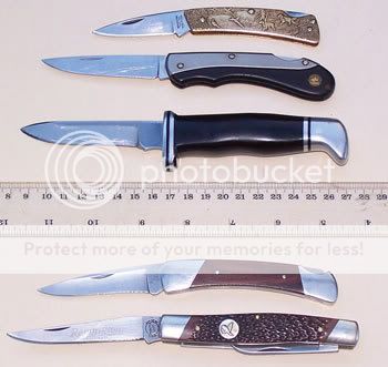

can someone ID this buck fixed blade? It is the third knife from the top. (I don't own the knife and got the pic from the web.)

its a model 116 caper

Well Mike, four micarta spacers and the general blade shape narrow it down mostly. I would not be surprised if the stamping were either BUCK u.s.a. or inverted three-liner containing the 116. It could be an early regular three-liner but I suspect it to be among the former stampings. In '69 micarta replaced the four red bone spacers so that begins my initial dating. The blade became a bit fuller with more 'belly' in the early mid '70s and I seem to recall that the fourth spacer just behind the guard was dropped around '74 so there you go Sir. I hope that is of assistance for you, Mike.
That, and I tend to have several Capers around the place. It mostly resembles the details I described.
Dave
Sorry....... I think Buck dropped the 116 and 118 and 121 near '98 or so. That is the sketchy guess at best.

You're welcome Mike! I hope my descriptions are accurate and believe them to be. I would place your lil' darling at mid '73 to mid '74 now with that stamping. Nice knife to be sure!
