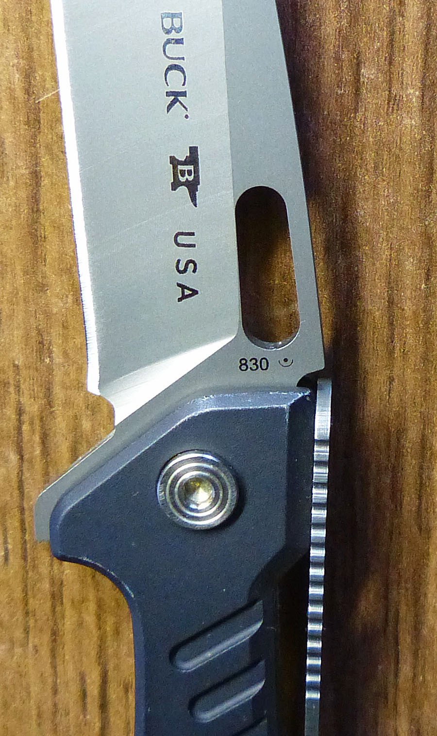

My Marksman was made on 6-18-14, the tools needed:
Pivot: T10
Handle screws & pocket clip screws: T6
2 Strap Lock screws: 1/16'' Hex
1 Strap Lock adjustment screw: .050'' Hex

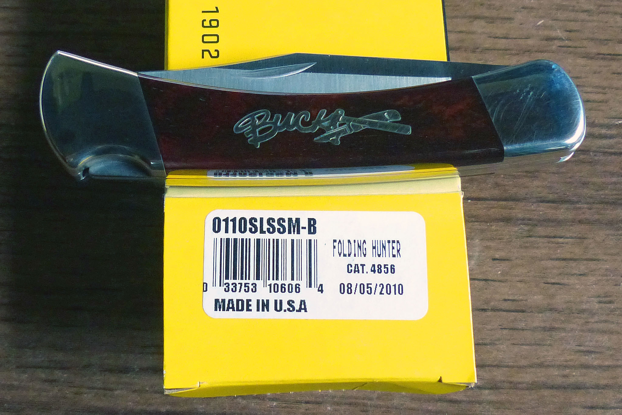

You will find the date of manufacture of the 830 Marksman near the scan bar on the container it comes in. In the case of this folder it is on the end flap: 08/05/2010.
Your Marksman, new for 2014, will have the year code etched onto its blade between the thumb hole and the handle. It looks like a tiny bowl with one grape centered in it (think female breast).
