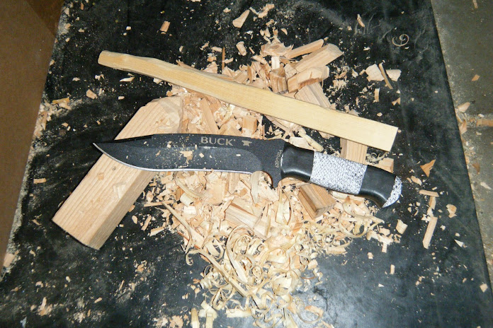

I bought this knife mostly because I liked the style and wanted to check it out.
I have a Benchmade Bushmaster with similar design and a 11” blade
It chops good for a 7” blade if you can snap cut. Something I need work on.
I compared it to my Bushmaster , Condor Lochness , Breeden Tessa & CS Kukri.
Each photo shows the same number of cuts per knife. 30 in the first and only 10 in the second.
All the wood was dry most was seasoned
As you can see all but the Breeden are larger.
The edge from the factory was very good and the 420HC held it longer than I expected.
It could shave fuzz sticks but I had trouble getting them long & thin. It might be the grind or just me.
I wish Buck would have used a flat/ saber grind I am not a big fan of the hollow grind and it seems wrong
for a knife like this. Still I don’t think it would affect the making of shavings.
I cut and chopped with the Reaper for about 2 hours enough to “clear a path, set up camp & feed a fire”
The edge held up well.

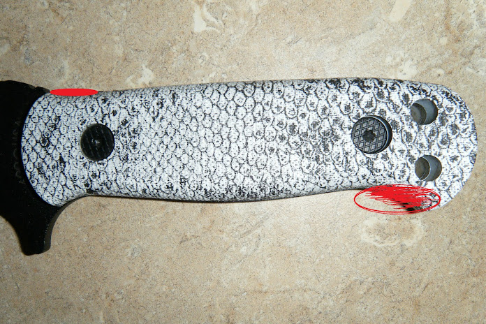

I did get two blisters form the handle. The slabs do not fit prefect also I am not use to chopping this much.
I put some rubber from a old inner tube over the hot spots and used my gloves (Why didn’t I think of the gloves earlier?)
Before I sharpened it I did a little more work with it
With the edge I could still make a bow drill set.
I love the design I would like to change a few things.
Remove the swedge
Use a flat grind (not that the hollow grind was a problem)
The 420HC was better than I expected and Buck knows what they are doing. Still I would like a nice carbon steel like 5160 , 1095. Then again that would make it the Buck/Hood thug.
I paid well under MSRP for this knife. I intend to keep using it / playing with it.
I think it would make a great knife for a Go bag. Good overall size it can chop and do finer work also. All in a good stainless steel.

Great info, but I am wondering about shock when chopping. I see you mentioned blisters, and I am wondering about the feel as you were chopping concerning vibration or shock absorption.
The blisters were from ill fitting handle slabs. I do not think the shock is bad it is a light knife. With good gloves it is even less.
