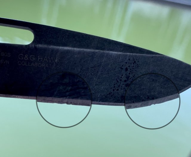

I have a Buck Marksman Inferno, a semicustom from SKBlades, which I love. But I recently noticed edge chipping in two places on the blade:
I’ve had the knife for about two years and never sharpened it. It has held an edge extremely well, except for this chipping. I have not abused the knife, but I’ve used heavily as an EDC for all kinds of stuff, from shaping bits of lumber for small woodworking projects to cutting heavy rope and some bushcrafty stuff.
Has anyone seen this in Buck’s S35VN, and will Buck repair this under warranty?

Sometimes when the initial edge is applied at the factory with a grinder or belt sander, it can overheat the edge ruining the temper - resulting in brittleness and chipping. Reprofiling the edge by hand (not machine) - maybe multiple times - can remove enough material to expose the properly heat treated and tempered steel. This can result in a much more stable edge.
I’ll agree, the factory edge can chip as two of my s30v blades have and a 20cv. After getting the chipped edge removed by hand with diamond stones and re profiled they haven’t chipped yet. I don’t know if it’s heat and grinding to fast or if it’s the grinding force that is loosening the carbides at the very thin apex where there is less metal for structural strength. IDK Maybe both. So far my S35vn hasn’t chipped and two of my s30v blades haven’t chipped. It would be interesting to know for sure why this happens to new factory edges and after hand sharpening they don’t chip.
S35VN was intentionally designed to be slightly tougher than S30V. It gives up some edge retention as the trade off. That said, it is still not really a tough steel and the toughness is very dependent on the entire heat treatment process.
Burnt factory edges are very common across the entire industry and I suppose it might be a factor but my experience is that usually means quicker dulling rather than chipping. But it could certainly be thinned and brittle as a result.
The likely culprit is the wood working. That's lateral stress and can lead to chipping, especially in higher vanadium-carbide steels. But as others said, if you've been using that untouched for two years for the tasks you mentioned, I'd say it is doing well. Sharpen it and go back to using it. I don't think I'd drop the profile any though and some might advocate a micro-bevel but I just don't bother with them.

And this was touched on earlier, but would anybody recommend reprofiling the edge to prevent future chipping?
depends what you want to continue to cut with it. if harder wood is a regular use of the knife I might widen the bevel to around +-35 or 40 degrees inclusive. should hold up fine to wood if none to very limited lateral pressure is applied when working the harder wood. really just depends on what you're cutting and what you experience while doing it. adjust to minimize/eliminate it. this assumes there is no metal defects of course.
could also send to Buck and have them sharpen it out and watch and see if it happens again under same cutting tasks.
