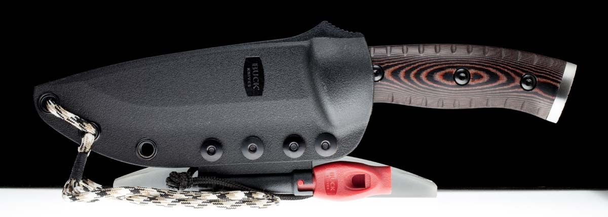

The sheath is a plastic formed sheath that retains the knife very well, it has a place on top for your thumb to push against to draw the knife out. The sheath comes with a belt loop thingy, but I removed that and added a static cord...inspired by Joe Paranee, saw that in one of his well done videos of Matt Gregory's Tanto and that led me to this. The paracord wraps around either a belt loop or my belt, with the knife removed from the sheath, I slip the sheath into the paracord loop so it's now held captive by what you wrapped it around. Then slipping the sheath in between my belt and body, the knife rides there fairly safely, a pull on the handle and the knife/sheath will pull out until the paracord reaches the end of it's tether and the knife pulls free of the sheath.
It does leave the sheath dangling, but returning the knife BACK to the sheath I find it to be a whole lot safer, as you have the sheath out and you can hold it while putting the knife back into the sheath. Nice Joe :) And Matt Gregory!
The sheath also includes a fire starter that has a whistle at the end, works well, haven't started a fire yet but I don't think it will be a problem.
Here are a few images of the knife
Buck_Selkirk_sheath.jpg~original

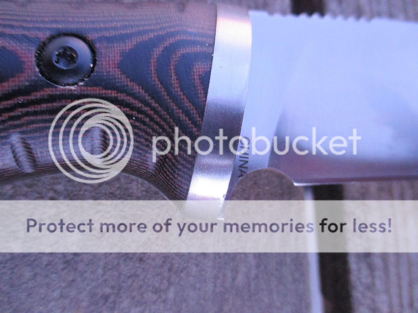

There is a small notch before the edge, this is intended for you to use to strike the firestarter there instead of the spine of the blade. And the guard is pronounced so it does provide protection of your hand sliding up and onto the blade.

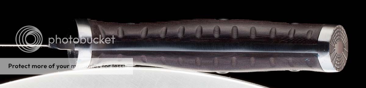

Handle is nicely contoured too with some texture along the edges, it could stand to be sand blasted for better grip which I might do down the road, or just some coarse sand paper to rough up the surface.

I have had my Selkirk for around 9 months. Overall I like the knife and find it to be an excellent value for the money. It has reasonable ergonomics and for the most part a good enough fit and finish. Mine did come with one very minor cosmetic defect, the truncated "China" tang stamp, which doesn't effect functionality of the knife, nor does it warrant a return or an exchange.
