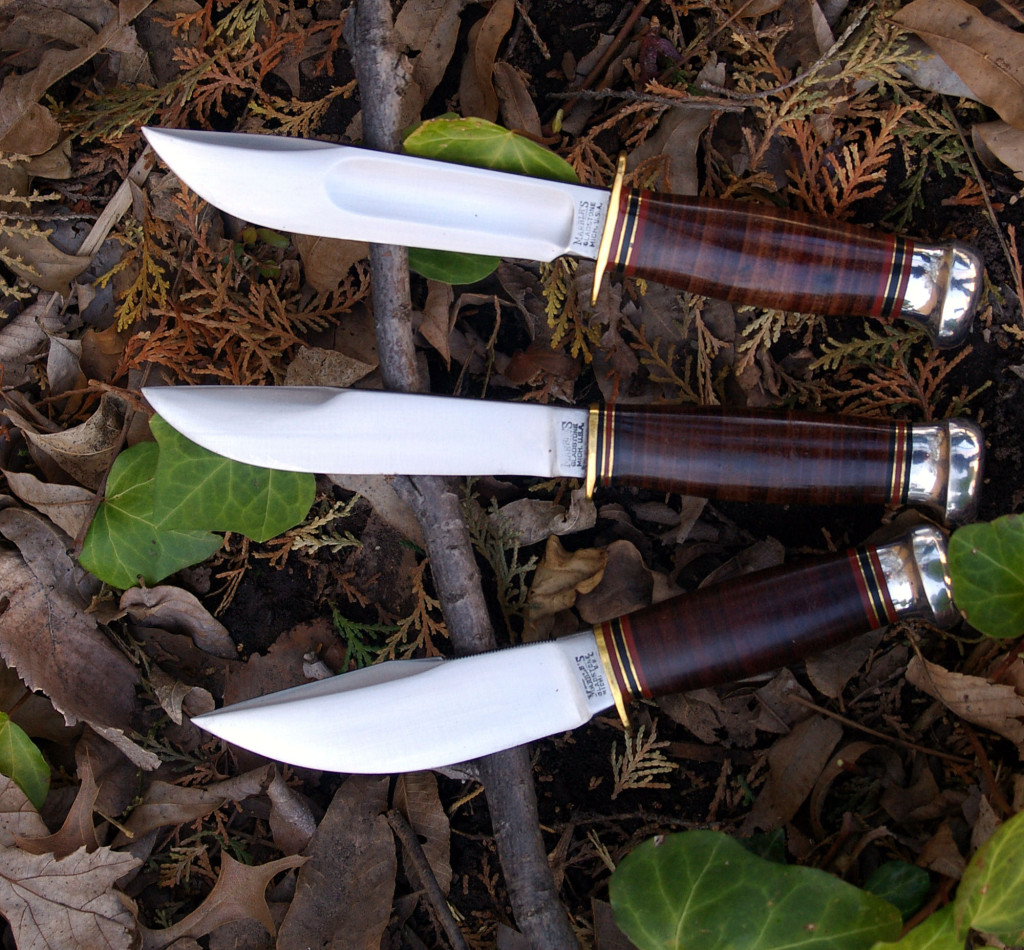

The Selkirk is feature rich and probably what you need. But, I love the Vanguard and I own two. I won't be switching anytime soon.
Here are some pretty pictures to sway your decision.

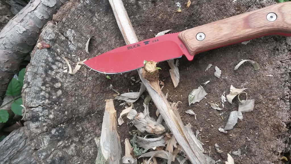

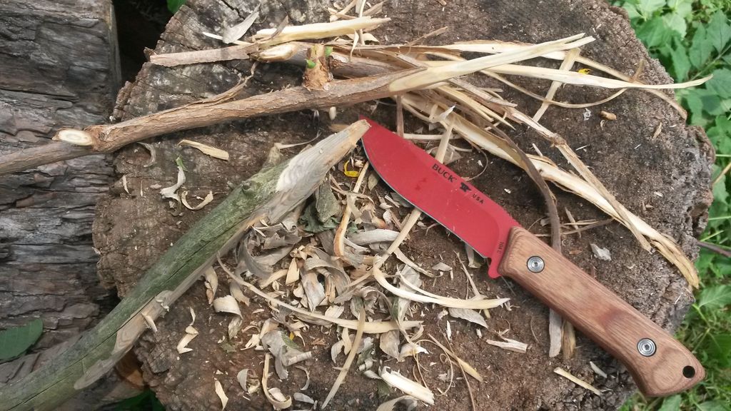

Prince (the Artist) would have called this the "Little Red Corvette" of Buck knives. :cool:
I took it out and cut old dry and fresh cut sticks. Did fine. It feels good in "my" hand which translates into a feeling of control over the blade. Overall, a workable Buck solution to the need at hand. :thumbup:
Well done BuckShack. I can add that the Vangard can be found in 425M steel and one up grade steel on a special run. (Cabelas S30V) Something to consider. DM
