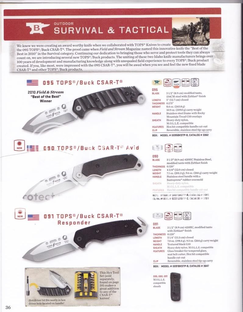

I've had my eye on getting the CSAR-T For some time now but wasnt aware of the Avid and Responder versions that came out. From what I understand, the variations are in the grips and steel.
http://www.knifeforums.com/forums/showtopic.php?tid/900524/
Is there a significant difference between 420HC and ATS-34? Does using 420HC make the blade less costly? I did a quick search and a few posts on another forum said 420HC is tougher than ATS. True?

Other difference's in the original CSAR-T "Pro" model and the other two is that the Avid and Responder use a thinner (.120" vs .175") blade making the knife thinner and lighter. The Avid is 1.5 oz. lighter than the "Pro". The "Pro" also comes with a reversable pocket clip as well as a sheath, the Avid has no clip. It appears to me that the Avid is nothing more than a folding Alpha Hunter (model #279) with a different blade.
