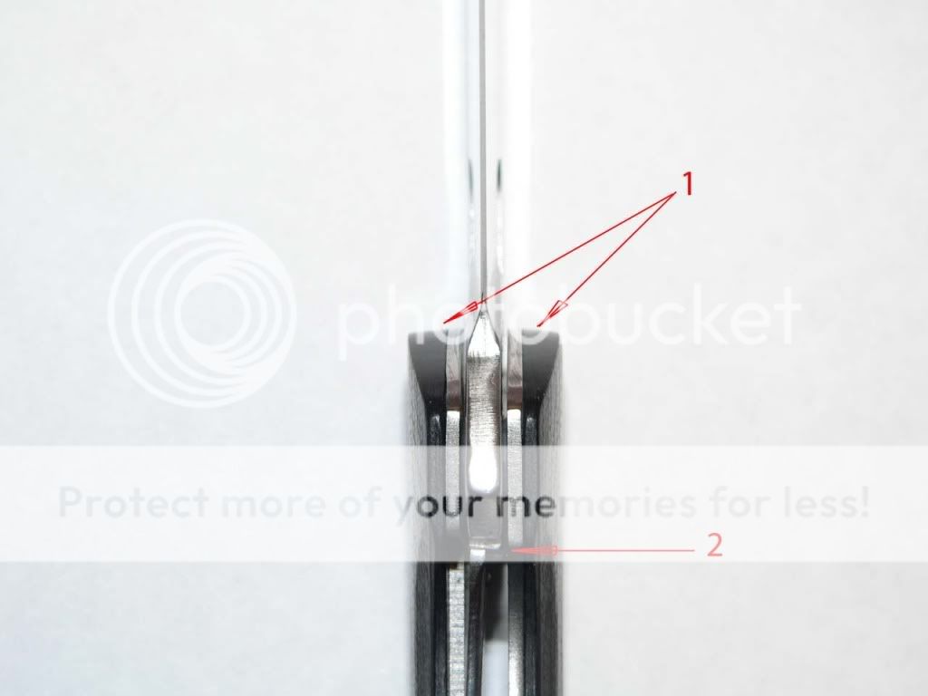

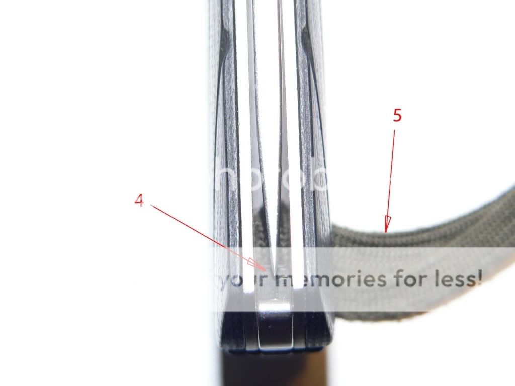

First thing I did with Vantage PRO is took it apart and fixed some of the things I didn't like. Here is what came out in the end:
1) Sanded G10 scales and liner to get a good fit
2) Lockup was great, I didn't do a thing (but with Vantage it is a hit-or-miss game)
3) Lock edge was way too sharp, so I rounded it off. Now it is very comfy. I probably will grind it down closer to the handle later on, just for looks.
4) Blade was somewhat off center, so that was fixed.
5) Took off the clip and put a lanyard on. Lanyard is held in place by a longer replacement screw. Just took the original screw that hold G10 to the liner, put in a longer one. No other modifications.
I feel like I paid half for what (with a little effort) performs and feels like a $100+ knife.

The materials used in the vantage pro (G10, S30V w/Bos heat treat) are what you would find on more expensive knives. But it's so much cheaper, they seem to be saving money on fit/finish, which you took care of yourself.
so really, with your labor included, it is a $100 knife, lol.
