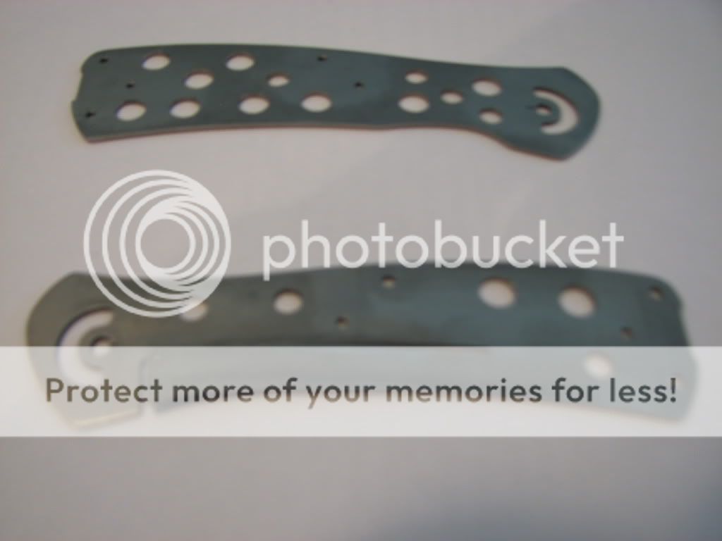

I've had my VP now for about 2 months, of course when it was new I carried it more but have found myself reaching for it less..
While I think its one of the most comfortable knifes out there I find its a little heavier then I like.....
I'm going to be lightening the load by drilling out some of the liner and was curious if someone has done this and how much weight was removed..
By the looks of the liner I think I can remove at least 1oz without losing any integrity..
anyone done this??
Okay I went ahead and drilled out the liners, I'm on my phone and when I get home later I will revise thread with pics!!
Edit: Here are the pics I took earlier before I left the house today for fireworks, ( I was in a hurry and didn't have my 3/8" bits near the press so I used the two nearest me 1/4" and a 3/16" bit..
Here is the knife apart.
Here are the liners drilled.
I haven't weighed it yet, so I will post back later..but I can tell the difference in hand.. Also the stock washers have little to be desired and intend to put in phosphor bronze washers so when I do I will fine tune some of my holes with a 3/8" bit as needed..

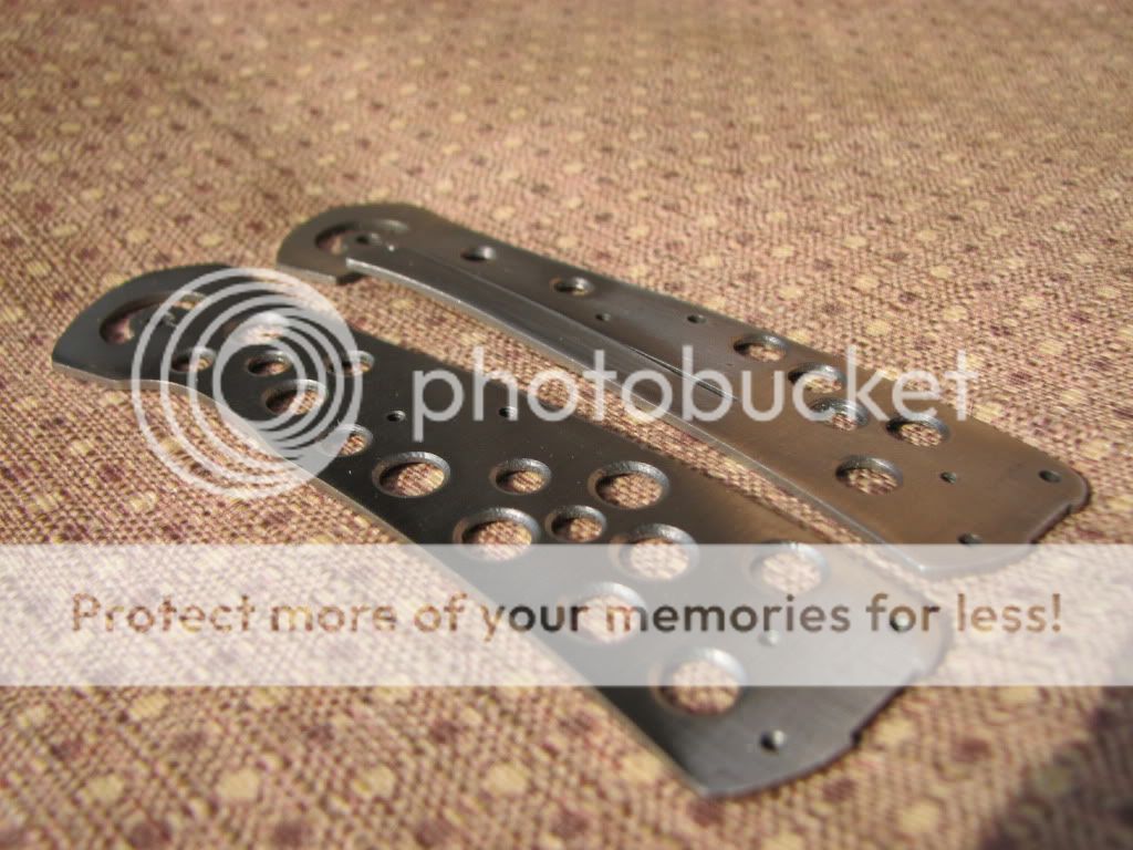

tonight or tomorrow I'll post more pics of my skeletonizing, I intend to take the knife back apart and drill out some more holes..

enter skelotonized liners.. last night I took the knife apart again and drilled about four more holes, deburred, and sanded the liners down..
I guess I'll have to measure the washers to get the size as I can't find reference anywhere on sizing... the knife will remain apart until I get new washers, I may buy both bronze and nylon just in case the bronze doesn't work for some reason.......
I have never checked the balance point so IDK, but I will check it once the knifes back together
