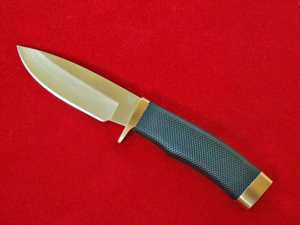

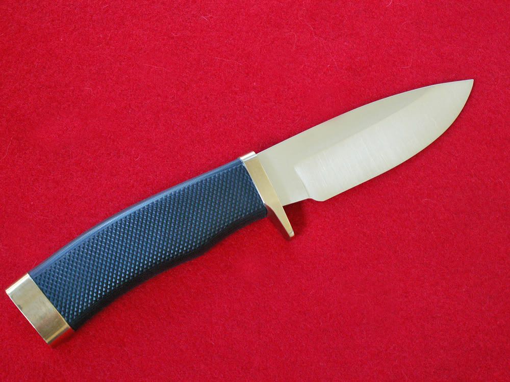

I just now managed to get a couple of pictures of the Buckcote Vanguard that I bought from a fellow forumite. It's a REALLY sharp edge. It's a little hard to get the color of the blade to show up, but it's pretty close in the first picture.
