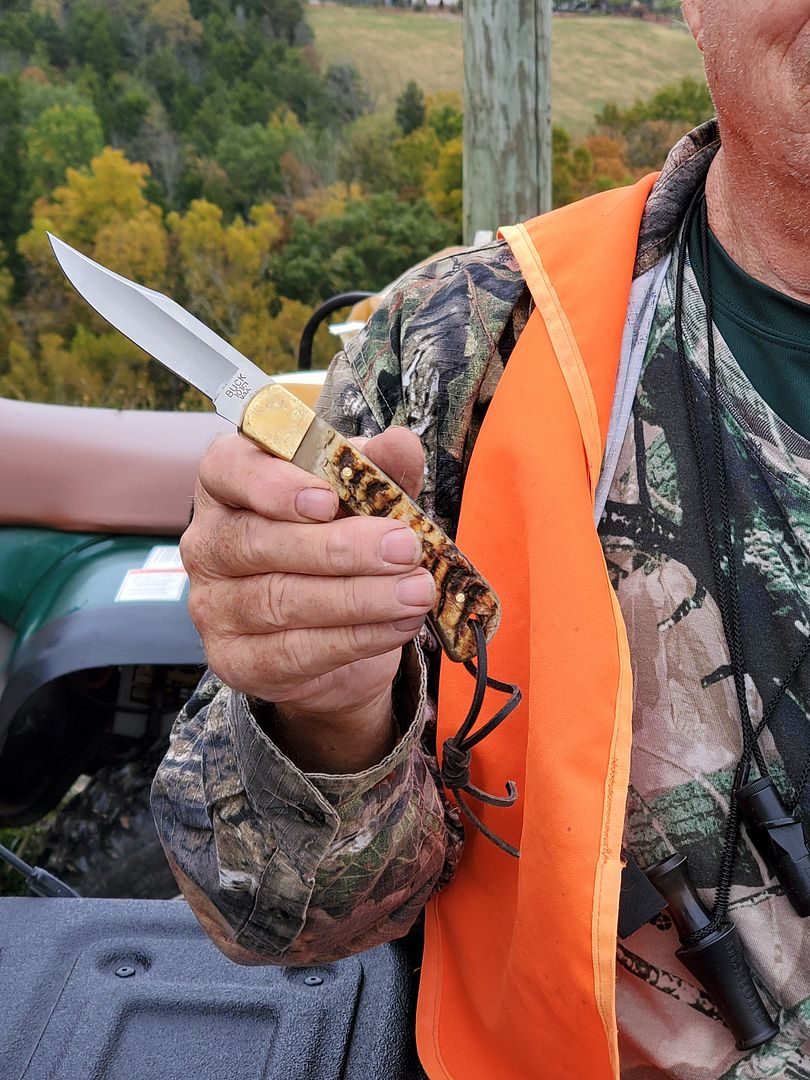

I gifted a 101 to my cousin this season in 420 and he field dressed 4 deer and several other critters and has yet to sharpen it.
