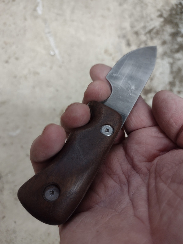

Some of my first handles and mods were with my Porter Cable..... Idk why anyone never made a base mount for it, to turn it into a nice little portable belt grinder....
Actually I know why..... Cause I Wanted to.
But their handles, and mounting locations are Not in user friendly locations to use and mount stuff to.... Which is a shame, cause it's a Wonderful unit.... I love mine..... But it could be better!
This handle for a Becker might be my first...?
I made it on the Porter Cable
