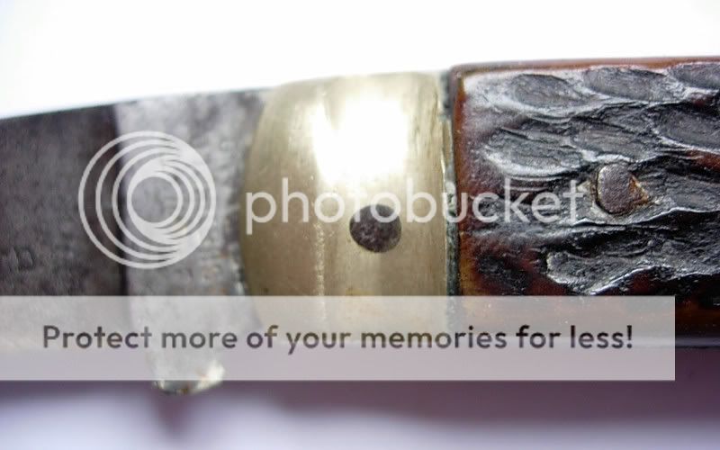

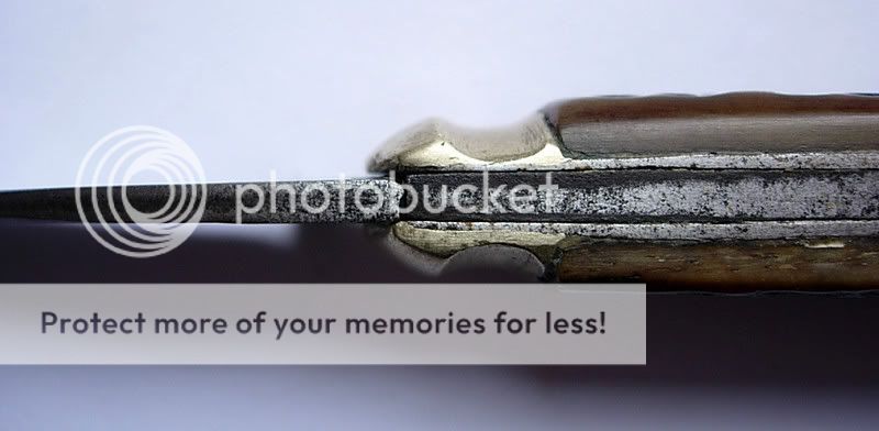

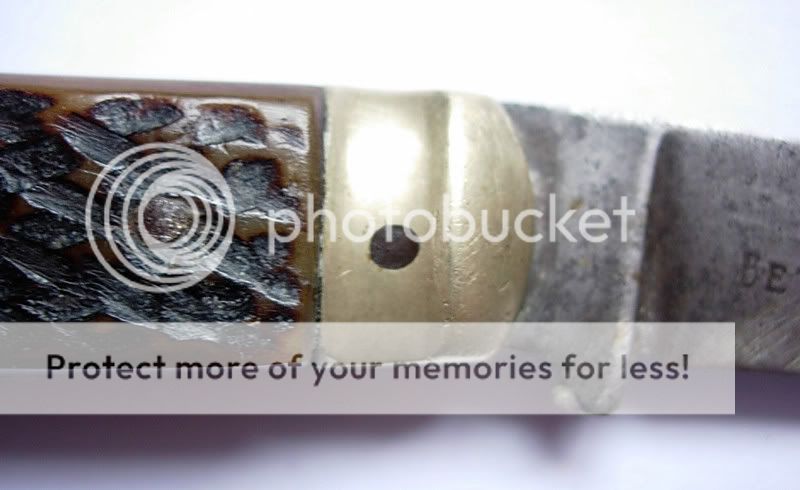

Here we go. The fit between the back of the tang and the spring isn't great on either. Looks even worse with the close-up detail. The patina looks relatively consistent. The pins look ok to me from my novice perspective. I appreciate your feedback. Thanks in advance.
Not the greatest fit. The elevation looks ok, but the thickness is off. In my opinion, it looks like a replacement blade, from the pictures. That tang/spring area can often yield the best clues as to originality. The knives that display steel pins in non-ferrous bolsters are almost always German, in my experience.

WN is right, the thickness of the blade is off (being a replacement blade would explain why it snaps open but not closed too). The fit from handle to bolster worries me too. I doubt a knife of that age would of had such a poor fit and that adhesive left showing like that. Still an interesting knife to EDC if nothing else.
Thanks for your input MM. Looks like the evidence is mounting. It does not look that bad at real size. I think you're right...I may just use it around the house.
