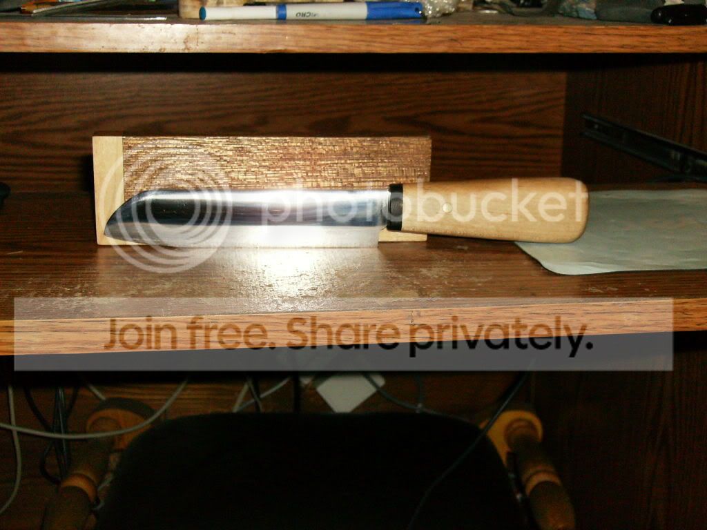

patrice im new and learning but what ive learned my self so far is one buffing wheel for one color compound to do the buff proper. I switch and will build another buffer soon with a double . To really do it right you should have 5 different buffing wheels white green and black for metals and white and brown for wood. Im finding that the brown leaves a blackness on maple so i switch. I also some times only usethe off white and green on metal. samona uses numbers to describe what each number represents as far as polishing on metals goes. I use the compound from rob at ranger you will not be dissappointed if you order it in the green block and get the brown for wood as well very good.This is what my last knife buffed out like . kellyw
Buffing compounds vary from manufacturer to manufacturer, and vary greatly in grit size quality control. The general rule is you get what you pay for. In knife making, we usually are not trying to get an optical polish, so it doesn't matter as much. The color is sort of the guide. The darker the color, the coarser the grit. Black is emery, and is a cutting pre-polish of coarse grit. Gray is finer, then brown,cream, green, pink, white. The pink and white leave very little residue and are good on wood. The green is good for general purpose ( once the finish is fine enough to buff) and green is best for stainless steels.
