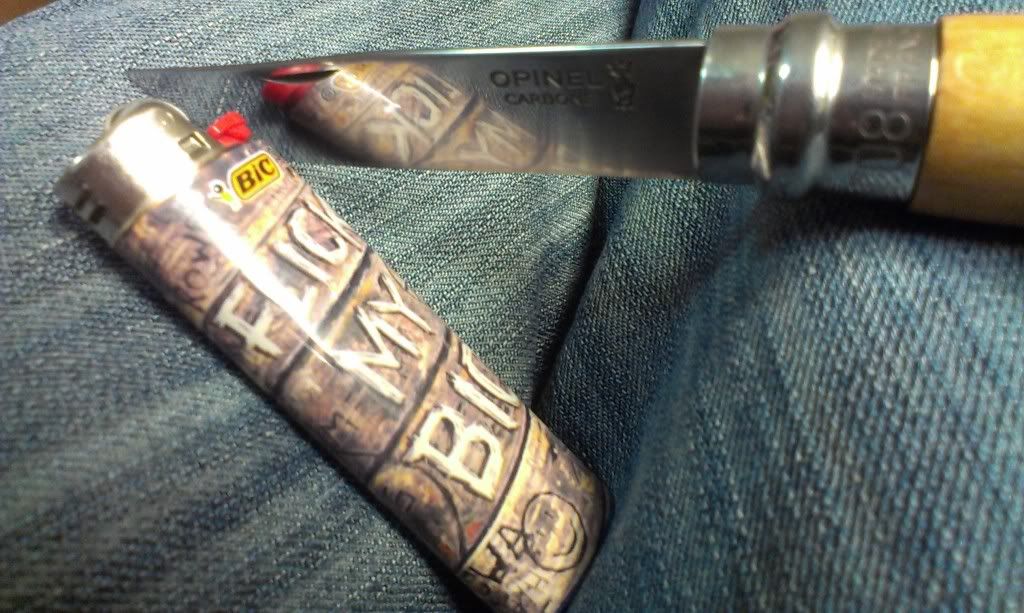

Not unless the scratches are very shallow. I'm working on polishing my Opinel as we speak and I had to go down to 800 grit just for the shallow machining marks.
Crappy pic, but this is after much elbow grease and 800 followed by 1000 then worn out 1000.
Soon I'll go to 1500 and may go as high as 2500 but I doubt it.
Oh btw, an eraser would probably work well. I started by using a hard block of wood but I was getting high and low spots, so I put a piece of leather between the paper and wood and it's worked very well. Just enough give, yet still firm and it gives me a large area to work on.
