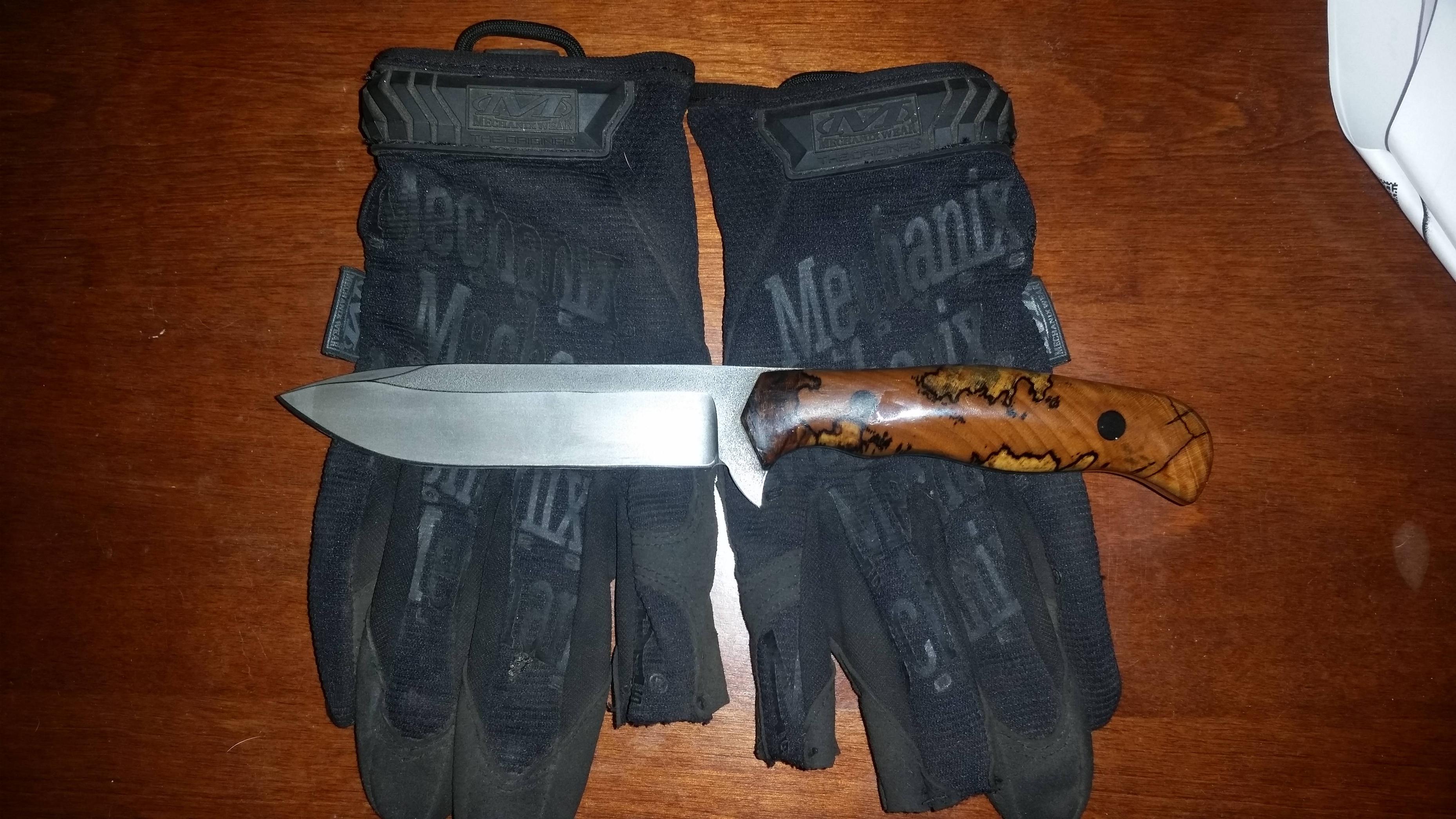

Ok guys there's some of my previous work. Not the best of pictures but I'm getting better at that portion of the job. The last link is the design I've come up with. 9 and a quarter long overall. What do you guys think? Also I've heeded advice and will be going with micarta rather than CF
Since you asked...
The peak in the middle of the cutting edge will be a bitch to sharpen on the fly, especially with the recurve portion right behind it.
The thumb ramp if executed wrong will be uncomfortable if used for any length of time. Maybe tone it down some and add some light jimping to it so it's not quite so aggressive but still serves the purpose you're looking for.
The finger guard by itself should be plenty to keep the hand from sliding forward. Add some contours to the micarta handle and it'd be pretty danged secure.
Keep the butt flared out the butt just a little bit side to side or create a little bit of a hawk bill to be able to securely pull the knife out of something so a gloved hand doesn't slip off when wet.
