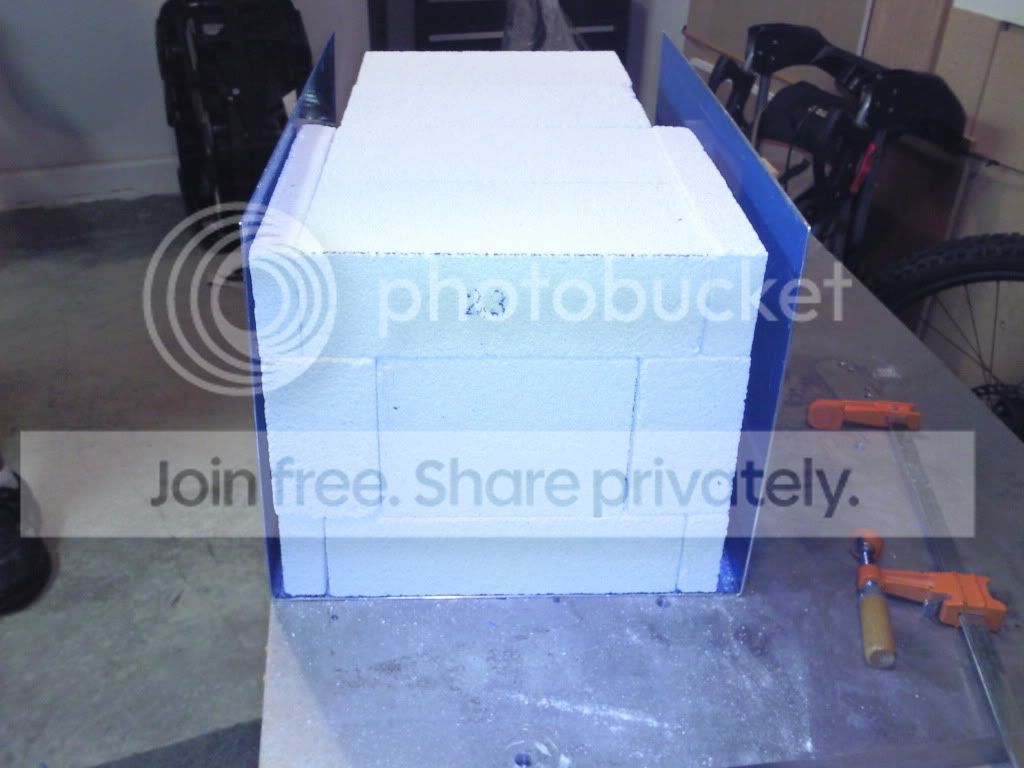

Hey guys. A friend of mine is finishing up his Masters in engineering and has to do a project. We were going through ideas that could be fun and as soon as a heat treating oven was mentioned we saw no further need for discussion :D So, going off the tutorial from british blades and making a few slight alterations we have all the bricks cut and most of the body/frame ready to go. So, to my question. When I picked up the firebrick I asked the guy about inswool and he said that that they had quite a bit of "scrap" that I could have and he gave me probably 15-20 sq ft of 1" inswool. So, this is a whole new ballgame for me and I was wondering if adding a layer of inswool between the brick and the frame would make any difference? I have never used a forge like this or used inswool or ever used firebrick so I don't know exactly how they insulate. Does the brick insulate so well that the outside of the brick doesn't even get hot? Would inswool do anything for insulation/efficiency or just act as a spacer with no thermodynamic effect?
Here's a shot of what the back of the forge will look like:
I was also wondering about the element. Do I need to buy a wrapped kanthal element? I have heard of people wrapping their own and I have access to a lathe and other equipment so I can wrap the wire myself very easily if its easier this way...
I would put the inswool between the brick and the forge/oven body. All the brick only ovens that I have been around get quite hot on the outside. nice looking oven son far
K - so with the inswool I know that the air pockets play a major role in its insulating properties but how will it function if crushed? I'm wondering about the bottom of the forge - if we line it with inswool it will be crushed by the weight of the bricks so it will greatly decrease it's density and thermodynamic properties. So, is it worth lining the bottom or is it a waste of time? I have enough room to either do a single layer on the top and bottom or 2 layers on top, which would be most efficient?

BTW - speaking of parts, the heat controller we are using has inputs for 2 thermocouples to equalize the 2 readings, where is the best placement for the 2 thermocouples?
