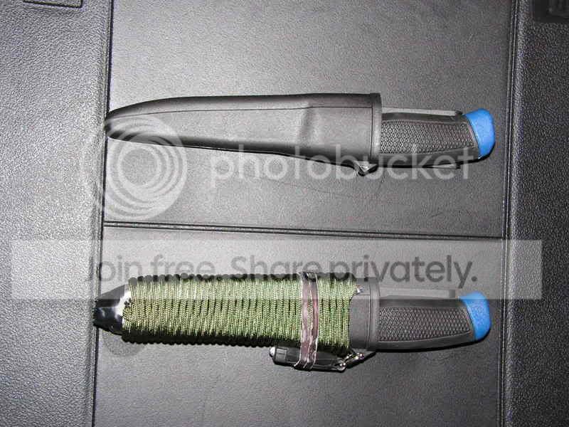

Just got back from a trip, both Moras waiting for me on the doorstep. Gave this sheathing thing a test-run on one of them, didn't turn out that badly, will take pictures later.
I started out by taping an orange Mini lighter onto the back side of the sheath near the tip, couple layers of duct tape and some electrical tape on the end so the silver doesn't show. This made it thick enough on the end to cord wrap (Thanks for the link, stingray!) with some OD I had lying around, and managed to tuck in a couple Micropur tablets along the back side as well with a strip showing at the top to pull them out easier. Whole thing is still compact enough that I can wear the thing in my front pocket, clipped to the watch pocket in my jeans. Unless you look from the side the lighter-bulge doesn't show at all.

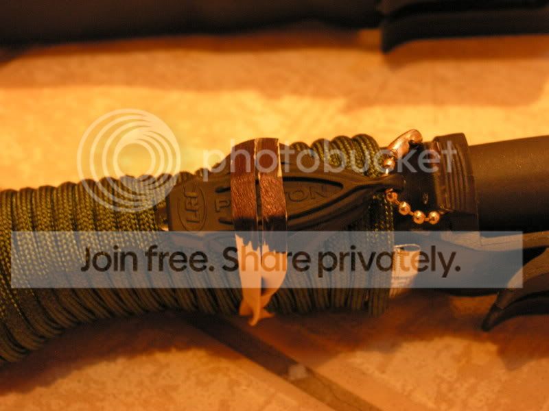

What I'm rather proud of, is how I solved the problem of having an easily accessible/detachable light. I noticed a little thimb ride on the side of the sheath to push on while drawing the knife...drill a hole through it, slid in a tiny length of bead chain with a clasp, and threw on a Photon Freedom (I have a small collection of the versions, I can mix and match LED and body color) in a quick release holster that blocks the button so it won't come on. One sadly non-matching rubber band around it to keep it from flopping around, and I have had a very fun half hour on the thing. Might pick up some inner-tubing later to protect the Photon better and match the rest of the sheath, but overall, I'm happy with it.

As promised, poorly lit pictures.
Here it is side by side with its stock twin brother.
From the side, you can see the bulge where the lighter is buried under the tape and cord.
Here is a close-up of the way I rigged the light through the thumb-loop. Was tricky drilling out the plastic to make way for the chain, but it worked out very well. I can unsnap the light from the clip and the band at any time, swap it out with a different color or version, the only problem is that the band looks like crap. Just need a ranger band and it'll look look fine and protect the light better. Also, notice the silver wrapping of the purification tablets tucked under the cords.
Things to work on? Tuck more tablets in next time, possibly use red or orange cord for an emergency kit instead of this more subtle version, and possibly just save the tape and ranger-band the lighter underneath the cord or over the cord if possible. With bright cord and a Doug Ritter yellow Photon on the side along with the orange sheath/handles...This could make a garishly visible piece of kit. But for now, I prefer it dark and blending.
Thats not a bad looking kit you got there. I'm not a fan of the stock sheaths that come with the mora's but that looks like it should work to me. I may try this myself to see how it does for me. Thanks for the pictures!

If that rig is supposed ti be a survival one, in my opinion the mini Bic should not be that deep.
Fill your bath with cold water. Enter the bath and lie in it with your clothes.
When you start shivering, try to unwrap your rig to use your fire starter.
You see what I mean? ;)

I'm rethinking the whole duct tape thing. Some inner tubing would make it easier to get out, without the extra hassle. The cord-wrap has held up, I'm confident this setup is indeed durable despite its flaws, I could bang this around for a year or two without worrying. Still a few more cold months before it goes out with me, more time for tweaking.
a solution to the lighter problem would be to attatch a small ferro rod to the sheath instead something cheap like a bsa hotspark is great for starting fires w/ a little practice, and works when wet.
