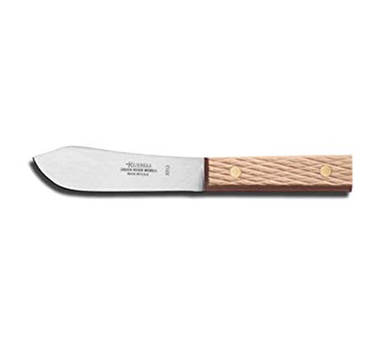

Building a Nesmuk from a 5" Green River rather than a 6" Old Hickory?
Sep 28, 2007
92
The Green is supposed to be a might thicker at the spine: .135" vs .090". That's not an issue as this will be a hunting/slaughtering knife I won't be batoning.
I have a 6" OH knife modified per the old internet instructions that works really well in this application. Would the 5" GR be a better candidate for this conversion than the 6" OH? (Or 6" GR for that matter). I'm questioning the ergonomic differences of the 5" blade vs. the 6" rather than the metal or build quality.

I don't think nessmuk knives are generally very large blades, so I'd check out the Russell green Green River 4-1/2" sheath knife which is practically a nessmuk already.
Btw as far as I know Ontario no longer even makes the 6" .
I could use the GR 4 1/2" sheath knife but it looks to me more like a Kephart except for the spine. I like the belly of a true Nesmuk hence my thinking the 5" GR would suit me better than the 6" model. My OH skinner 71-6" turned into a 4 5/8" Nesmuk. (The OH 71-6" is still listed as available, incidentally). My thinking is the 5" GR skinner might have more of the curved belly closer to the handle similar to the Grohmann Canadian knife or Scrteened's picture, where I like it. On the other hand, I think I'd find a .090" thick blade a handier slicer than the .135" of the GR.
That GR has the concave back of the Nessmuk, too, without having to grind it out.
I think of my GRs as thin knives, but all my OHs are older ones and I guess OH went to thinner stock a couple years ago.
I turned a Green River Buffalo Skinner into this-
The Buffalo Skinner is thicker blade stock than most of the other Green River knives. Specs are-
5" Buffalo skinner blade blank
- Overall length 9"
- Widest part of the blade is 1 3/16"
- Tang is .140" thick
- 5/32" pin holes

Fantastic work! What are the details on the burlap micarta scales? where did you source the slabs and how did you go about finishing them?
Thanks! I made them. About a dozen layers of burlap and West Systems resin. Cut on a band saw, glued on with G-flex, copper pins. Then I sanded to 220, and coated one last time with more West Systems to fill little air bubble voids.
Well they really look awesome and really complement the whole project perfectly. Thanks for the information.

I couldn’t tell you. I made it as a gift, and it lives in Connecticut now. It was approximately a 4” blade and 4” handle. The other option is a Green River sheep Skinner. That’s what I used for this knife-
It’s a little longer than the Buffalo Skinner. Overall 9 5/8", blade is 5 1/4" x 1 1/4" x .132 thick. I actually prefer the Sheep Skinner because the handle is a little longer. Can’t measure this one either...another gift :)
Nice job on your old hick by the way!
I like the Sheep Skinner too but from your pics and the catalog it looks to me like the Buffalo Skinner has a little bit more belly. Is that my imagination?
In any case, I like the flat grind on the GR blades compared to the sort of sabre grind of the OH even though this one of mine performs and handles really well for me. I just need a project to keep me busy through January and February.
