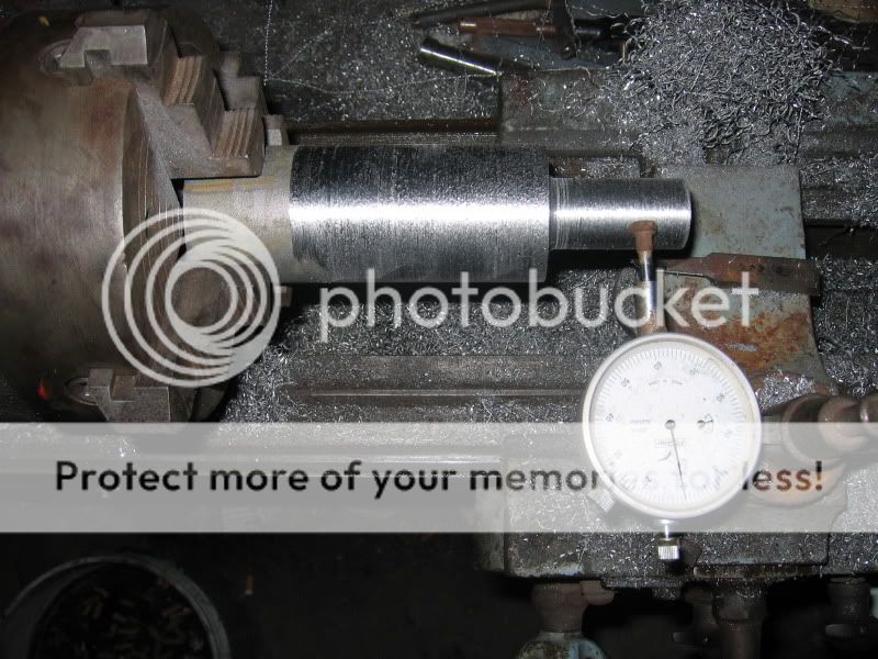

123, so far I have the 1050 normalized for turning down on the lathe. I need a dial indicator first since I can't have the rollers off by more than .01 or I'll be wasting my time. So far the biggest PITA is lack of funds but after the holidays the damascus market should speed back up.

Well after 6 hours in an 18 degree shop...
The end is within .007 and the center will be also. For some reason the ends were perfectly centered (to each other) but the middle of the bar was out by .040... but 1050 at $.50 a pound, can't complain.
I need to order a real flat belt for my lathe and replace the 1/3-1/2 hp motor with the 2hp I have laying around. She'll turn metal like there's no tomorrow and I can avoid hypothermia. :D Right now I'm limited to 1/32" deep, slow passes since the leather belt slips so much. Anyways I should have this roller finished tomorrow. :)
