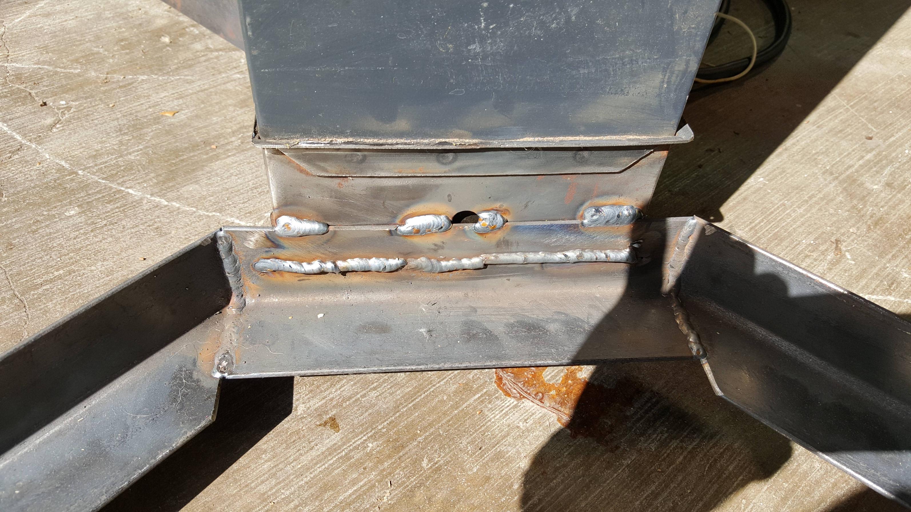

Out came the chop saw and I welded up some new legs for it.

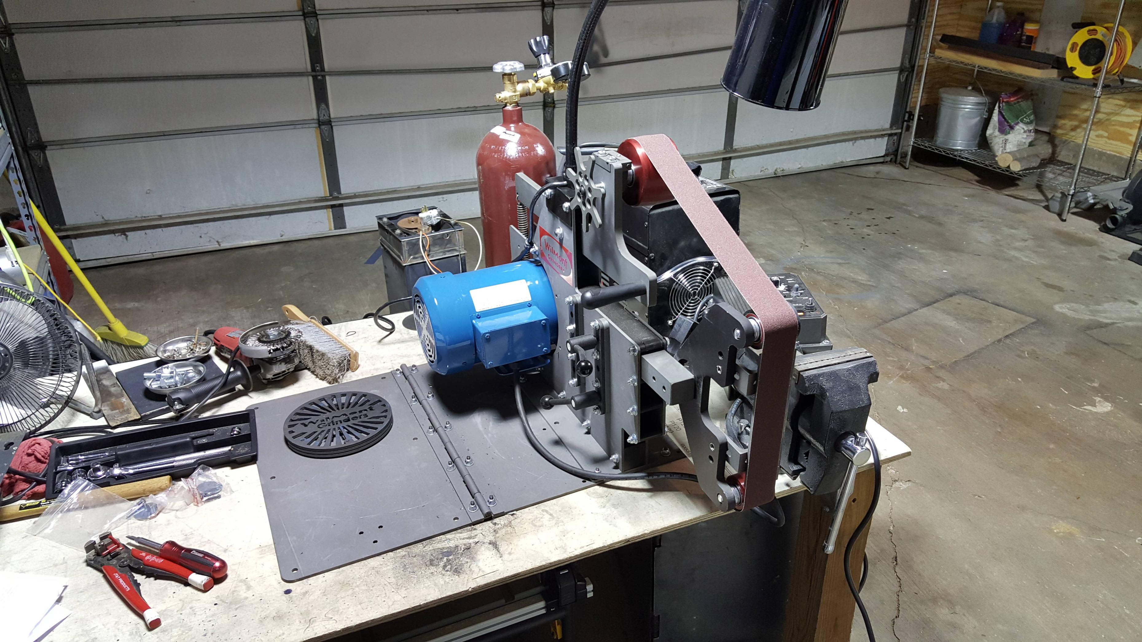

Lift as it looked initially:
New grinder:

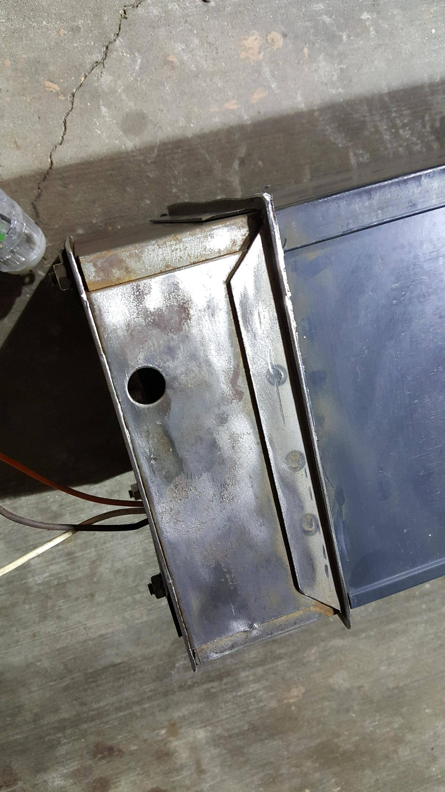

Bottom of the lift, with the legs chopped off and a wire wheel taken to all the rust:

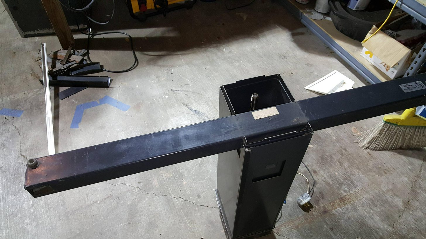

Top of the lift and the arms the desktop used to be secured to:

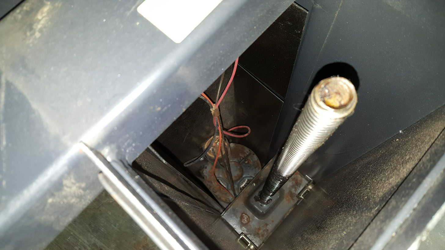

Interior of lift column with ball screw and motor:

The other problem I have is that the lift is about eleven inches too tall at the fully collapsed position. So I'll need to cut off the top and build a new one. Which will be exciting, because the column itself is sheet metal, and I'll have to trim the ball screw and figure out how the max height adjustment setting works so it doesn't overtravel and throw the grinder onto the floor.

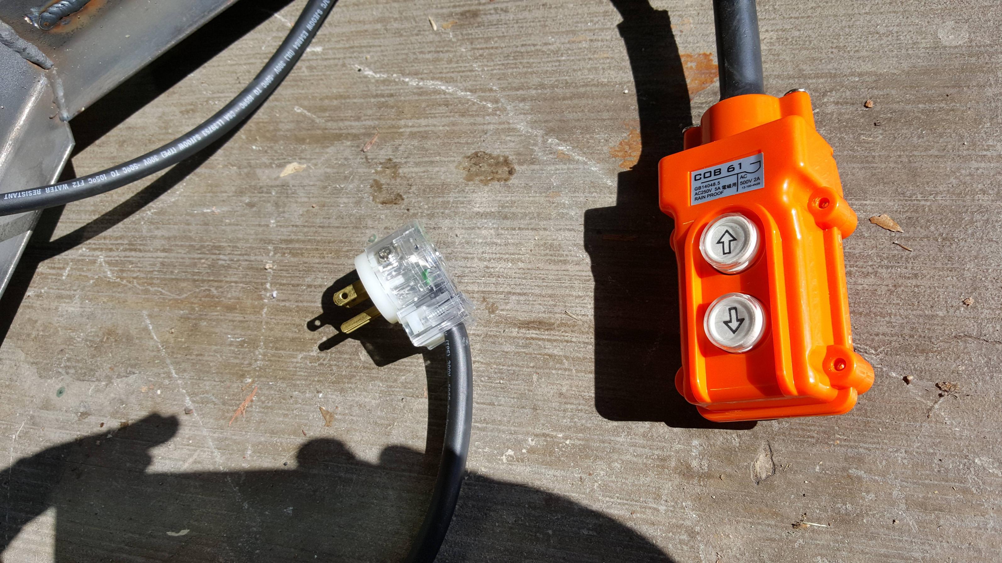

I added a lift control to replace the foot switch I'd taken off to make things easier. Plus, it looks dead sexy. I found it on Amazon here for $10 and took a gamble that it would work well. The thing is built like a tank! I also added a nice industrial plug and heavy-duty wiring to match.
My welds probably won't win any awards, but they're clean, fusion was achieved and they're structurally sound. Not bad for a hobbyist!

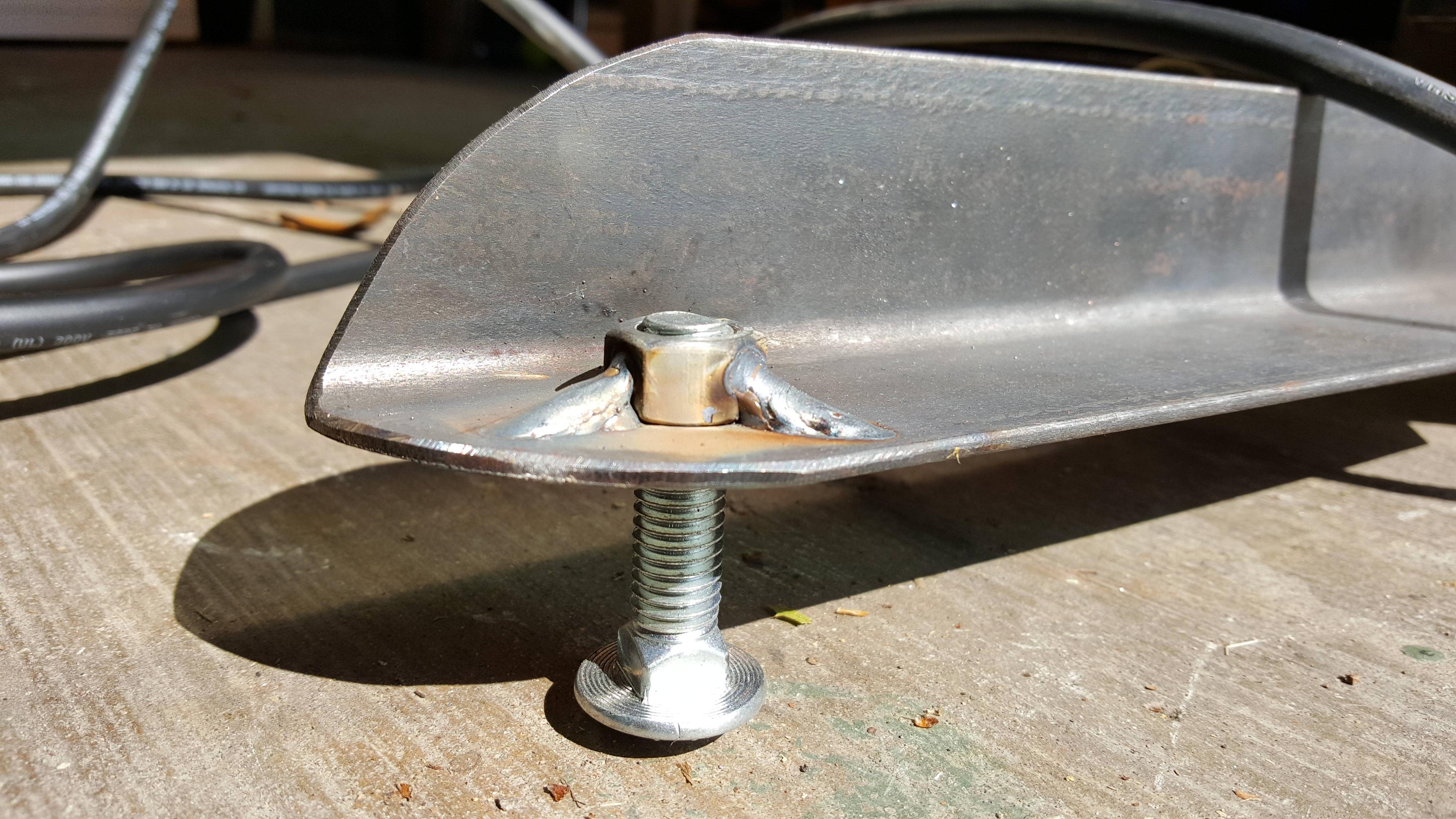

I haven't decided on whether or not I want it on feet so I can move it around, or bolted to the floor, but now I have the option to do both. Heavy duty metal feet were around $15 each, and spending $60 on metal feet alone was pretty tough to stomach. Then I noticed I had some very large and short carriage bolts laying around from a previous project and voila!
Also note how the angle iron stock is rounded away to avoid painful surprises with your feet and sharp corners:
