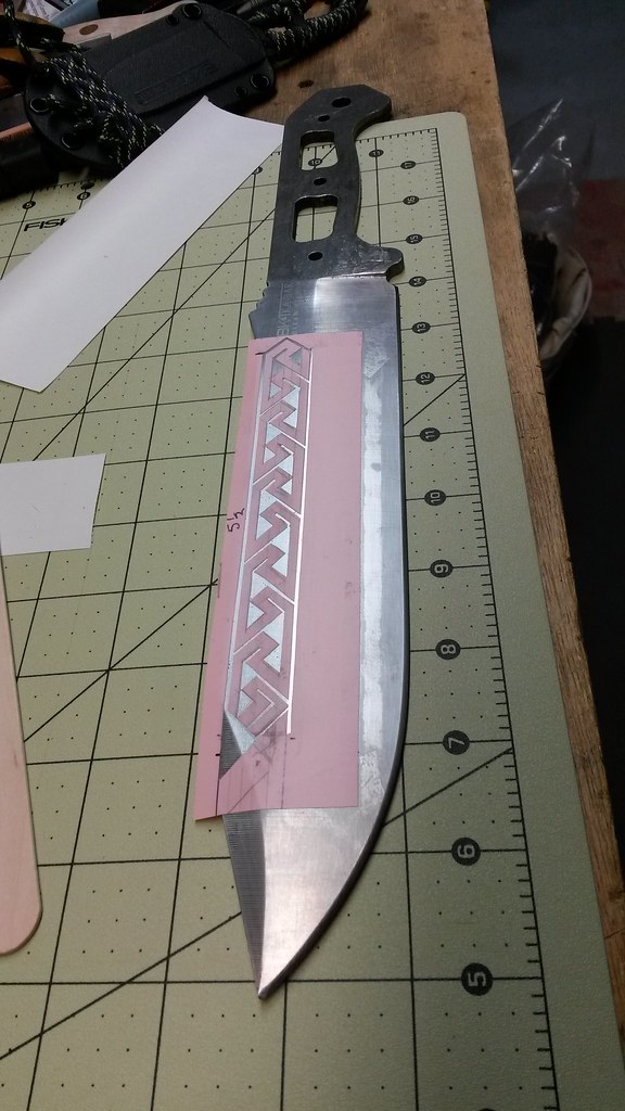

For this project, I didn't use a stencil; I just used the coating on the knife as resist. The Knives are laser etched through the coating leaving bare steel, but if you strip the knife the laser engraving isn't deep enough to hold up for very long. Mostly I just use the etcher for deepening the OEM laser etch so I don't lose it when the coating comes off.
For the BK-9 above, I used adhesive backed vinyl. The complete thread is here: Celtic etching on a BK-9.
One pic for clarification:
There are a LOT more pics in the thread.
